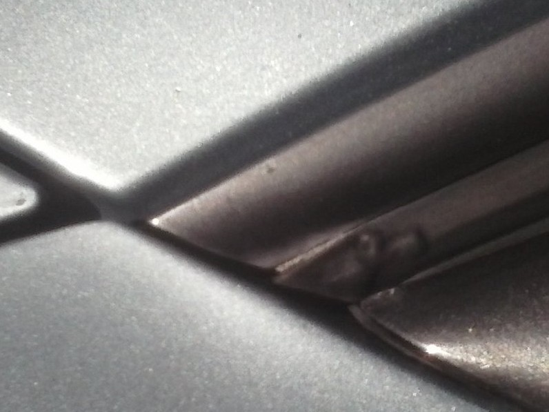

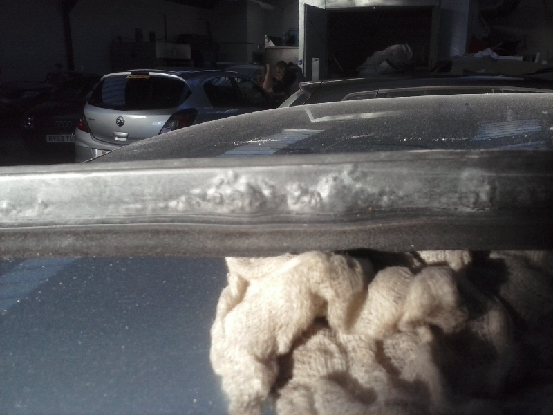

My problem is according to paintshop separation of rubber and alloy in the waist seal put them beyond repair - photos show end of waist rail fanning out and back bubbled out to half way.
As for the Edge finisher, there is no way to paint it apparently as it is rubber coated and alloy turned to powder underneath the bulges - again photos show bubbles on end of edge finisher next to door mirror and again at top of door. Other door is even worse. NB the drip moulding is the painted strip above this.

Attached Thumbnails What a price for door seals - is this just in UK?-end-waist-rail.jpg   What a price for door seals - is this just in UK?-back-waist-rail.jpg   What a price for door seals - is this just in UK?-bubbles-bottom-edge-finisher.jpg   What a price for door seals - is this just in UK?-bubbles-edge-finisher-below-drip-moulding.jpg

They certainly look beyond refurbishment.
Good used parts has to be a tiny fraction of the cost for new replacements.
