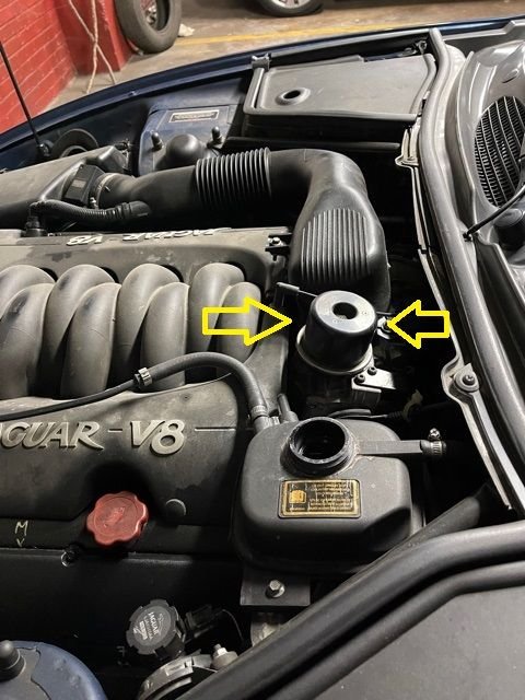

Default What's this?
Old Jan 21, 2021 | 10:26 PM
xalty's Avatar
Joined: Dec 2019
Posts: 3,695
Likes: 1,223
vacuum res for the cruise control, only found on the 97-98 AJ26 engine. there should be a vacuum line going to the nipple

or should do.
See this post from spuddyo:
https://www.jaguarforums.com/forum/x...07/#post674486

Thank you all. That explains the issue I've had with my cruise control. I took car in for service a couple years ago and they must have broken the top of the vacuum reservoir and glued it back on!!! I started having issues with the cruise control working intermittently afterwards and finally saw the issue with that part when the vacuum line came unglued... I will search for a replacement. Thank you all.

Way back in 2000 Jaguar warned us about broken stub pipes with a TSB.
Denial of warranty claims were not unheard of.

Thank you for that info. If it warranted addressing it in that manner it must be a rather common problem. CHeers
