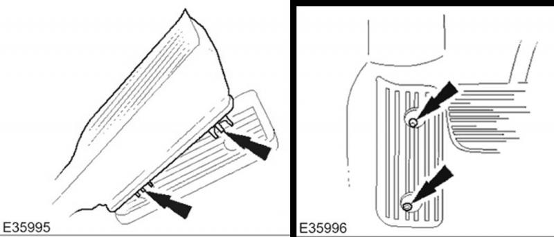

Here's my guess: part of the footrest
The footrest is in two pieces, a lower that is screwed down and an upper that clips to it. The lower has recesses where the screws go and the upper has two cylindrical parts that fit into those recesses.
Those cylindrical bits are just a friction fit and if someone removed the upper rest then one could have come off and been rolling around on the floor.
JTIS doesn't have a very good picture but the black arrows are pointing toward the parts I mean.

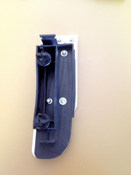

You can see the inside of the upper pedal better in this pic I took when assembling the aluminum pedals I put in.

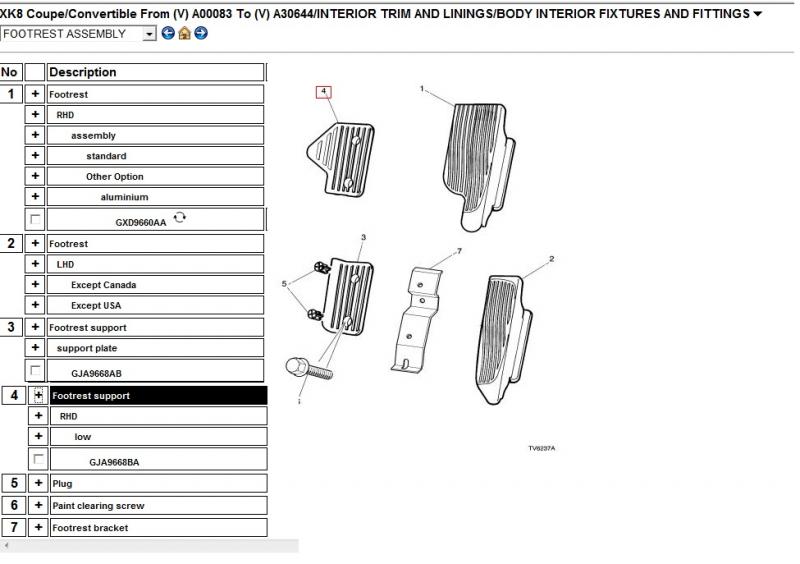

It's under Interior Trim & Linings:
I'd noticed in comments about the extended footrest that most of the complaints seemed to come from LHD markets. Looks like the RHD 'dead pedal' (item 1) is larger than the LHD (item 2).
