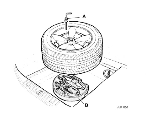

Does the spare tire also have a wheel cap or just the 4 wheels on the road?

The spare does not have a wheel cap because the retaining bolt (A) passes through the hole in the wheel centre to secure it and the tool tray to the floor panel.

It looks to me like the retaining bolt goes not through the center, but through a lug bolt in the drawing, and that is the way my spare is mounted. I have a 1998 XK8 if that makes any difference.
Old Oct 17, 2014 | 06:10 PM
YES - it does go through one of the bolt holes.
Still no centre cap though!
