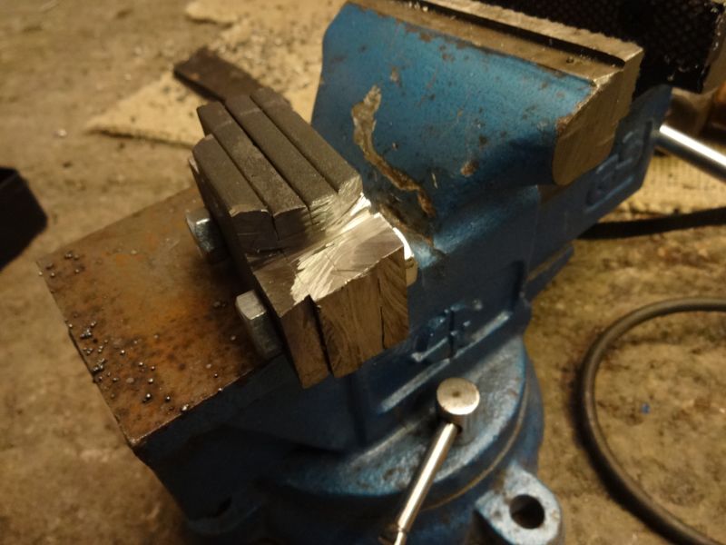

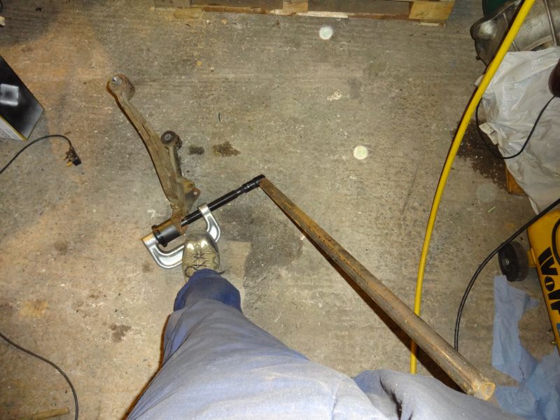

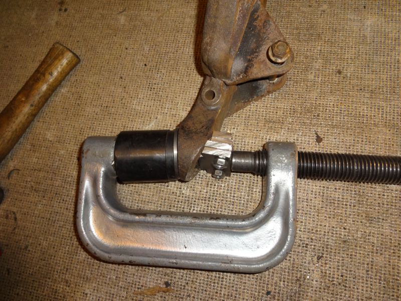

Remove the old one like this after cutting off the flange.
Getting the new one in is tricky as you need to make a tool.
Attached Thumbnails  Wheel Shimmy Cured w/ Lower Ball Joints-suspension52.jpg    Wheel Shimmy Cured w/ Lower Ball Joints-suspension53.jpg    Wheel Shimmy Cured w/ Lower Ball Joints-suspension73.jpg    Wheel Shimmy Cured w/ Lower Ball Joints-suspension75.jpg    Wheel Shimmy Cured w/ Lower Ball Joints-suspension76.jpg
