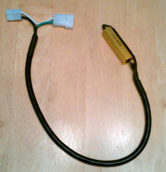

If one of you will sell me several of the connectors and and resistors and other necessary parts, I will make up several units and send them back to you for evaluation. It will give me an idea of how much time it will take us to make them, and the end cost, and give one of the established members a chance to confirm the wokmanship and decide if I shall make more.
If this seems reasonable, contact me at oxford@surfbest.net
Oxford
Old Aug 15, 2011 | 10:01 AM
Dennis07's Avatar
Joined: Sep 2010
Posts: 1,713
Likes: 451
From: New Jersey
Originally Posted by oxford
If one of you will sell me several of the connectors and and resistors and other necessary parts, I will make up several units and send them back to you for evaluation. It will give me an idea of how much time it will take us to make them, and the end cost, and give one of the established members a chance to confirm the wokmanship and decide if I shall make more ...
Oxford,
Speaking just for me, I don't think you need anyone's sign-off. Pretty sure Sam would not mind your going into the business as he has gotten busy with other things. A lot of people might appreciate a source for plug-and play units.
I've ordered a batch of resistors from an EBay supplier and will pass them along (when they arrive, it sure is slow) to anyone at my cost of $9.00. I won't be able to offer assembled units.
As a reminder, this is everything else you'd need:
- instructions to assemble, install and test your own system are on pages 3 and 4 of the System Description paper at www.scorekeeper.com/jaguar/jaguar01.htm
- The style of connector Sam was using (better, IMO, and not shown in the paper just mentioned) are these, as originally posted by Reko.
180908 Tyco Electronics / AMP Headers & Wire Housings
60249-2 Tyco Electronics / AMP Terminals
42565-2 Tyco Electronics / AMP Terminals
180907 Tyco Electronics / AMP Headers & Wire Housings
And below is the unit as built by Sam. Let us know if you need anything more.
Attached Thumbnails Where are the Convertible Resistors?-resistor-new-style-.jpg
