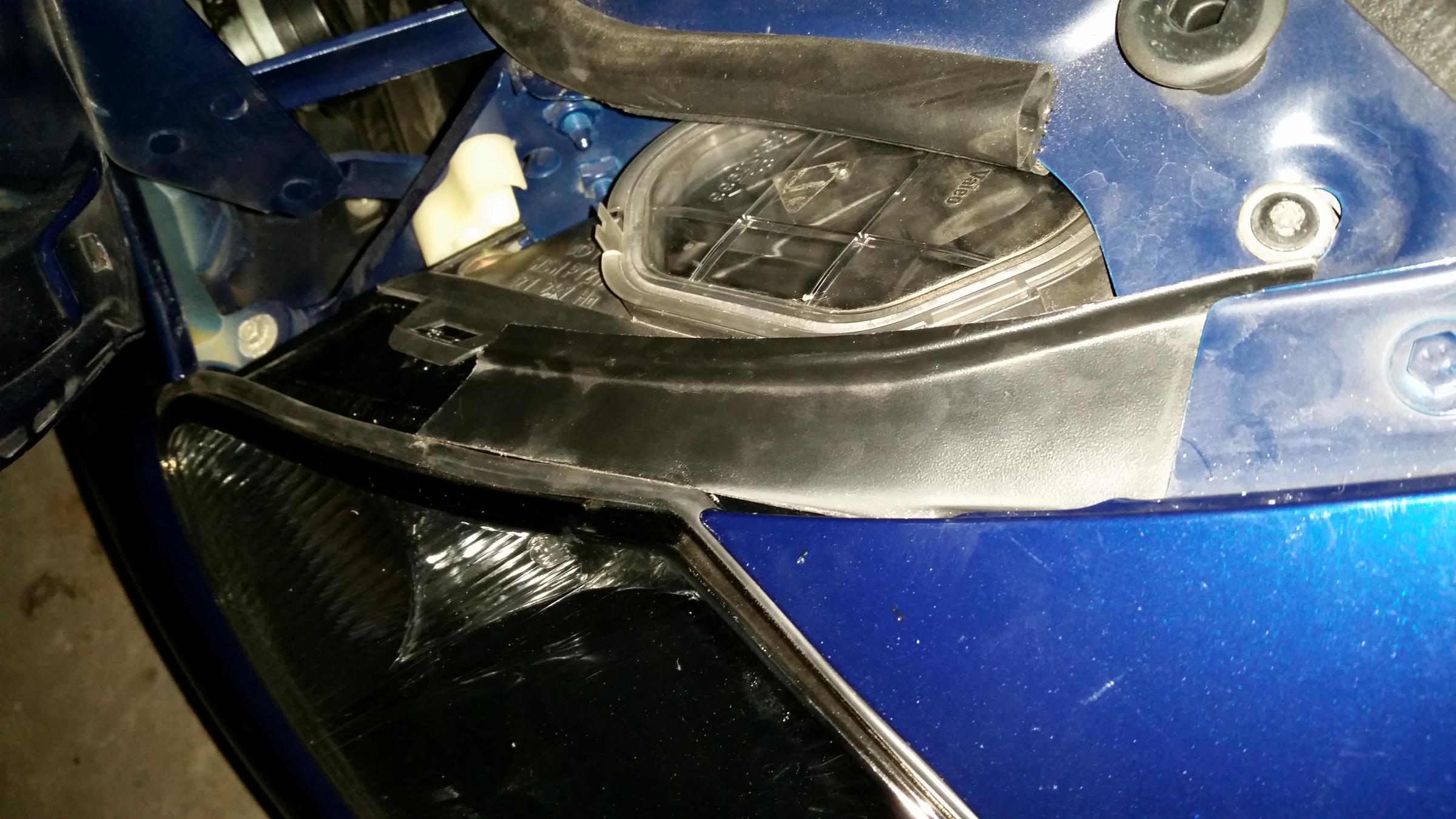

Can someone enlighten me where these 2 parts fit and act as supposed water deflectors on my XKR?
I cannot find them listed in my EPC and i cant find them listed in any forum threads as to how and where they are fitted.
Thanks in anticipation of a quick identification.
Part numbers are HJA3354AA & HJA3355AA

headlight deflectors (L/R)
DEFLECTOR, WATER RH HEADLAMP - Terrys Jaguar Parts - HJA3354AA
DEFLECTOR, WATER LH HEADLAMP - Terrys Jaguar Parts - HJA3355AA
how they fit - I can't tell and the SNG Barratts catalog does not show them

With the hood open, they fit on either side over the plastic access panel to the headlights with the vertical edge following the line of the fender. They're supposed to deflect water running down the seam between the hood and the front fender. I'm not sure what's supposed to hold them in place; both of mine are loose.

The deflector is held in place by being slid under the fender flange.
