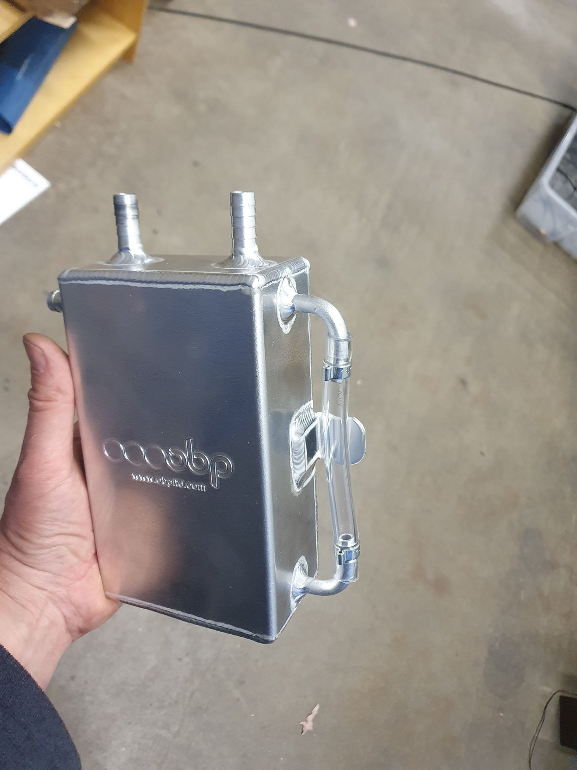

A few days ago I got the oil catch can I ordered a while back. My thought has been to mount it somewhere in the engine bay but.. now I realize there just is no space even for a component of this limited size. So where to mount? In the space inside the right hand side front fender?

Pardon me for asking but..........what oil are you catching? Breather overflow? And yes, there likely is room in the right front fender. I just had my inner fender off and there is a catch bottle of some kind (I didn't investigate) hidden in there with maybe enough room for yours. Easy enough to take off. Nice looking piece you have there. TM

Correct, it is the oil mist from crankcase ventilation I want to avoid feeding into the intake system.
Yes there should be sufficient space in the fender, I had the inner fender liner off before and from what I remember at least to the front there are a lot of empty space.
Wondering where others have put their cans, even though this is not a very common mod I know some folks has done it.
One con with mounting the catch can in the fender is that emptying it will require the liner to come off

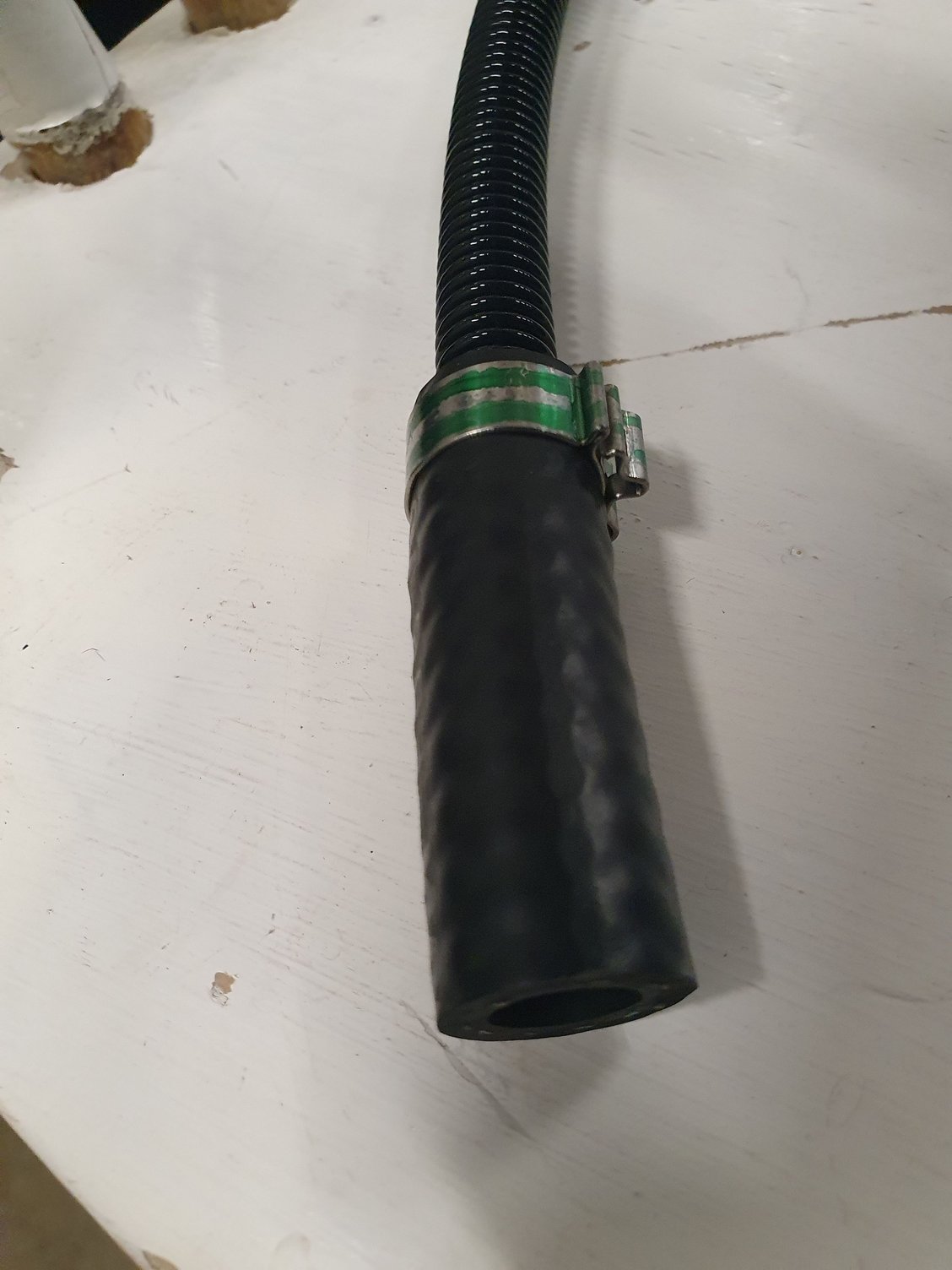

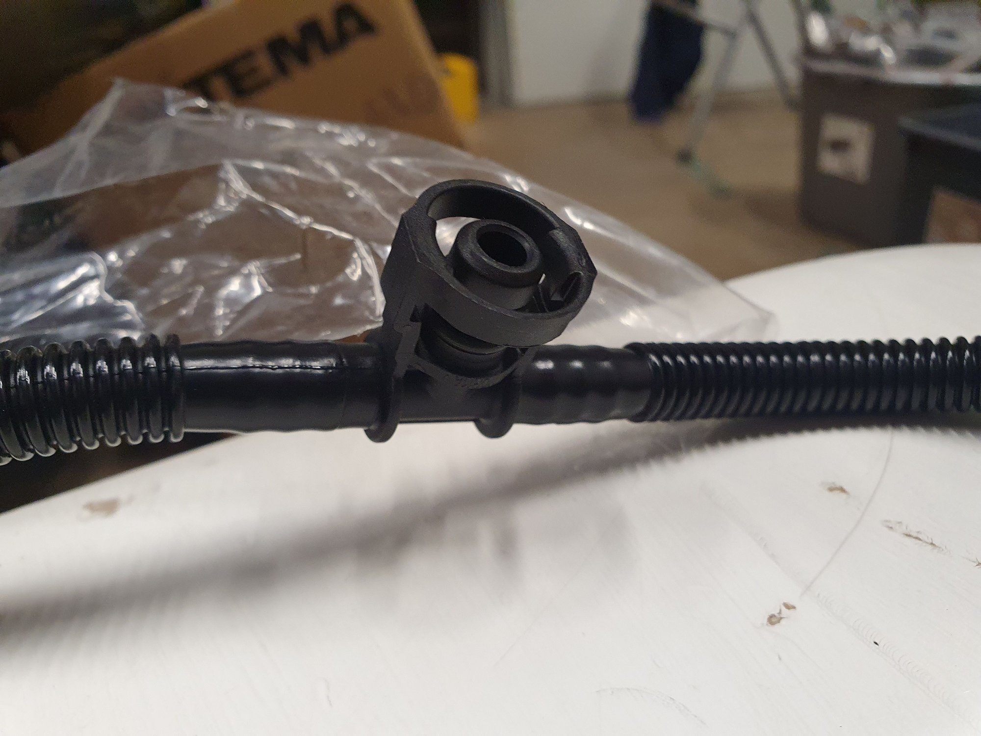

Just got a new part load breather hose delivered from Sng Barratt. I see that the "middle" connector on the hose is supposed to attach to the intake elbow, right? And if I instead want to direct the fumes to my catch tank, that connector is where I need to tap from?
The other end of the part load breather hose is fitted with a short regular rubber hose
That hose is connected to a olive green pipe that rises up from beneath the coolant expansion tank. Where does that pipe go and for what reason?

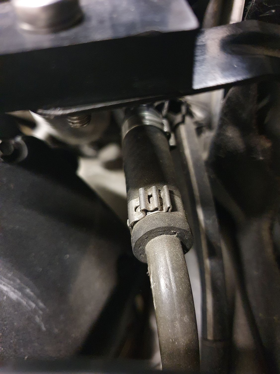

This is the olive green plastic pipe beside the coolant expansion tank. Anyone who knows where that leads?
