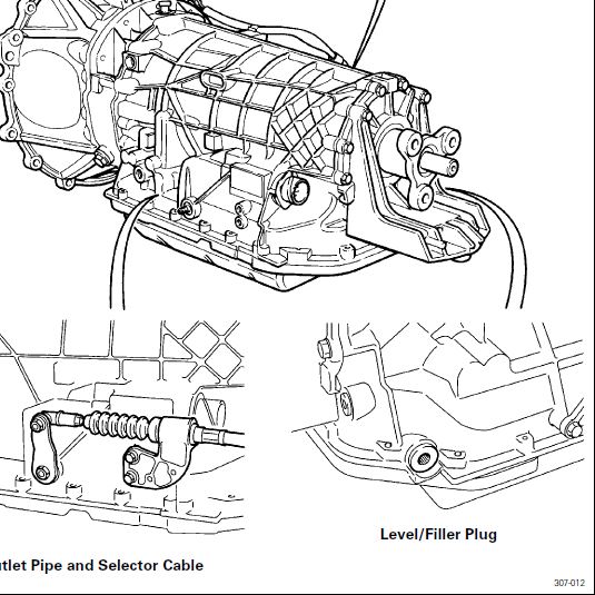

I have watched the videos of changing the trans oil but they never have a clear shot of WHERE the fill plug is located... anyone have helpful pic?

RHS of the gearbox just behind the exhaust pipe. A cut down allen key does the job, long series if you have it

But I don't have an allen head plug in that location... I have one on the left side (driver side) front that is about a 1/4 inch allen on about a 1/2-5/8 plug... could that be it.??

It's near the back on the right side, a couple of inches above the pan.

A picture is worth a thousand words. Here is what you are looking for. By the way to determine full is a special procedure with the engine running and in gear and filling to it barely drips back out.

Thanks guys... I found it... it is kinda hidden by the edge of the pan and exhaust pipe. I will fill per procedure.
