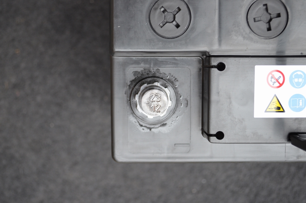

If it's the original battery, it will be a Varta in a UK spec vehicle.
The manufactured date is stamped on the top of the negative terminal:
The code is WW-YY so this one is Week 23 in 2012.
When you disconnect the battery you will lose 'learned' settings. The main one is the window limit switches. To reset them, raise the driver's door window fully and hold the switch until you hear a soft click after a few seconds. Next lower the window and again hold the switch until you hear a soft click. Repeat for the passenger window.
