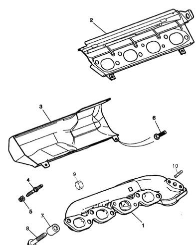

OEM exhaust manifold gasket for 4.2 SC engines from X350 and X200 cars is a nice alternative to wraps - it contains a full heatshield which goes around exhaust manifold. When I did my 4.2 engine swap I used these gaskets with 4.0 exhaust manifolds without issues. Some bending of car's underbonnet heatshields may be required.
