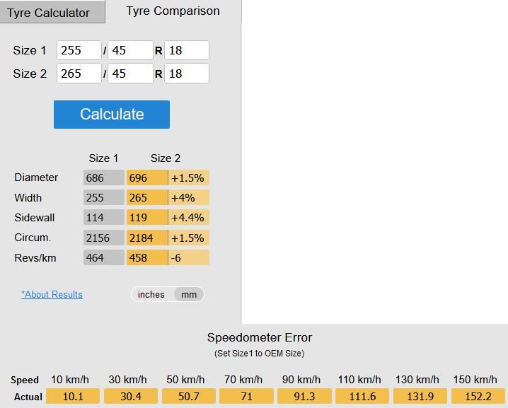

Here is the comparison between the 255 and 265

Hey Stumpy,
Pretty cool info. Did you get that from a web site? Share the link?

Originally Posted by professor2
Hey Stumpy,
Yes. The site I used was: https://tiresize.com/tyre-size-calculator/

I too use tire size calculator quite frequently. One thing to remember, more for the original poster than anything, just adding to or taking away from the width number actually changes the height of the tire as well. Thats where the calculator comes in very handy.
