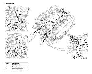

Old Jan 24, 2018 | 10:34 AM
Likes: 17,006
Not unless you start from the bottom with the oil pan and work your way up.
Hoses 3 and 4 aren't exposed by removing the camshaft covers.

Oh boy.. what an uneducated question on my part.. lol
For whatever reason, I though those hoses were closer to the valve covers and removing them would give easier access.

Yes - you CAN do it Graham's way, but allow for a couple of hours extra labour cost. !!
