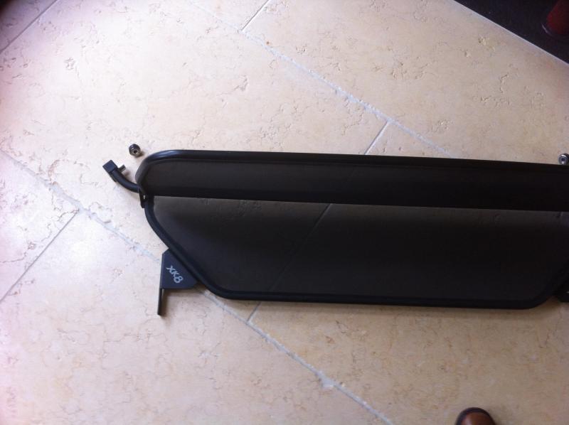

I think these are the mounts for a wind deflector JLM20658.
The parts you have are JLM201211 Mounts.
They should have 3 Plastic packesr that as you rotate will change the angle.
These are the parts that are always missing when they are sold on Ebay.
I have the complete kit without the instructions as to the exact position of the holes and can not find them anywhere.
Just had a look at your pictures again and they are exackly the same as mine

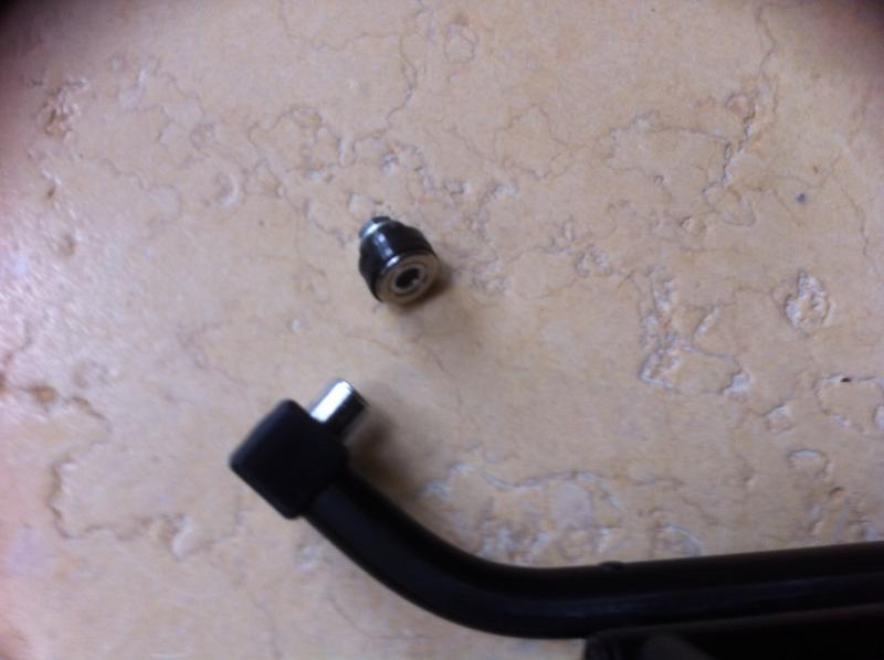

As you can see from the pictures these are the same.
A push button engages the wind deflector in to the mounts and a key releases it.
This is a genuine part taken from a Swiss 1997 XK8 so may be an early type.
Hope this helps
Hope this helps

The 3 plastic washers are all 3mm thick so are just spacers.
The crome fitting has a single sharp thread on the shaft that screws through the side panel and then a second thread at the back has the nut and washer.
The shaft is slightly offset, so if you insert an allen key and turn it should change the angle for fitting.
I am sure this is a Jaguar part as it was fitted by Jaguar Geneva.
I have seen these on ebay but they never have the fittings, as you would have to hide the holes when selling the car.
Your pictures are great, Im in Cran Montana this weekend to watch the mens down hill world cup.
Thats not the main reason, my farther in law has told me he has a set of new flute alloys with snow tyres in the basement some where.
Had another look at the fitting

Hi JJ
No the pins are round, what you can see in my picture is the thumb push that has a key to release. when you push this a smaller round pin comes out the opposite side into the fitting you have. The hex fitting seems to be for adjustment and to hold the fitting while you tighten the nut on the back.
My father in laws 1998 XK8 has sat from new in a heated underground garage all its life, it had 7000 km on the clock the last time I used it in Crans. This car looked like it had just rolled off the production line.
