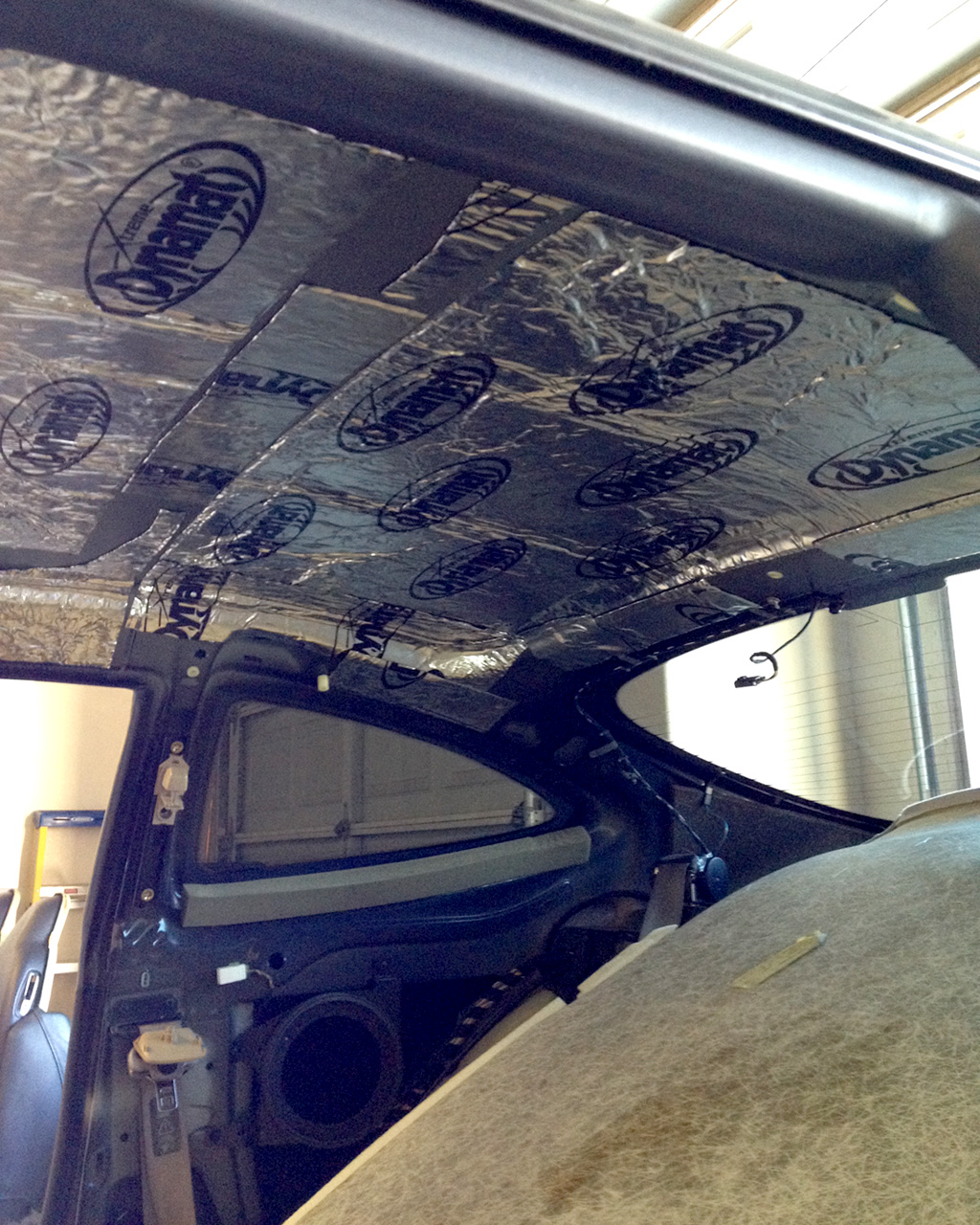

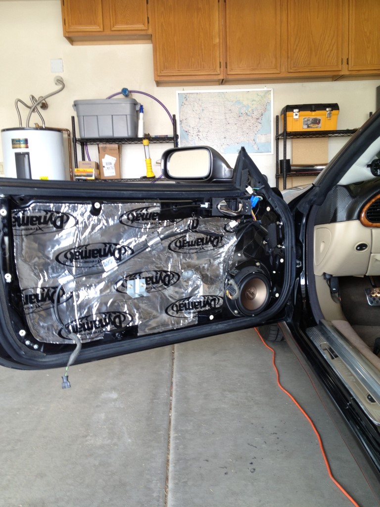

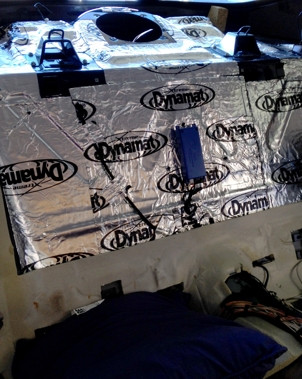

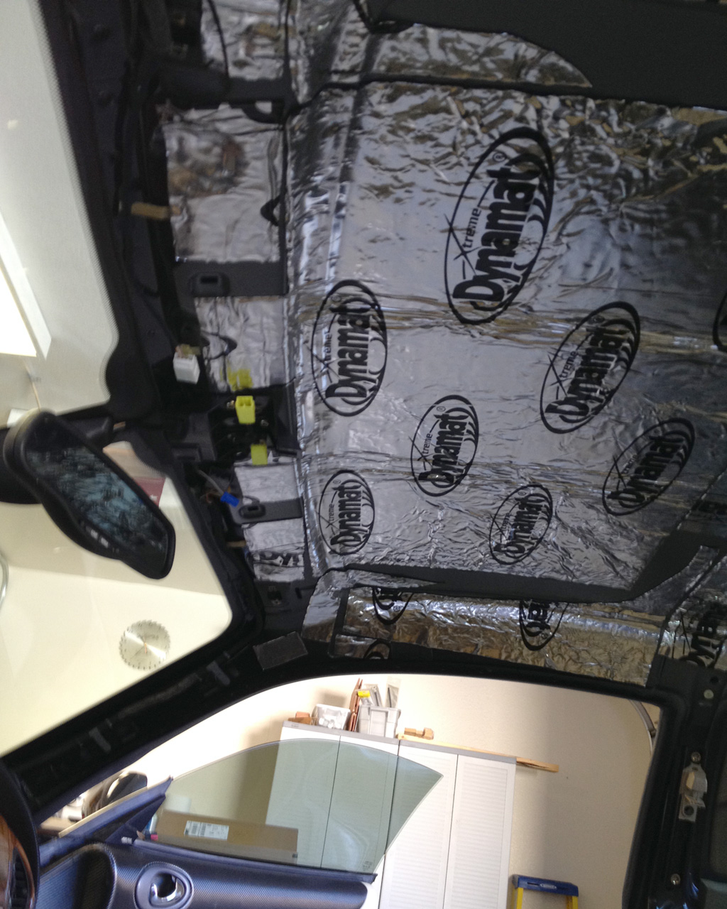

Here are a few pics of when I did the interior of my coupe. I also put some inside the doors, against the outside skin. Haven't done the boot yet, but been thinking about it.
As Rich said, makes a big difference.
Only down side is that it is pretty heavy stuff, but what is another 50 pounds out of 4000.
