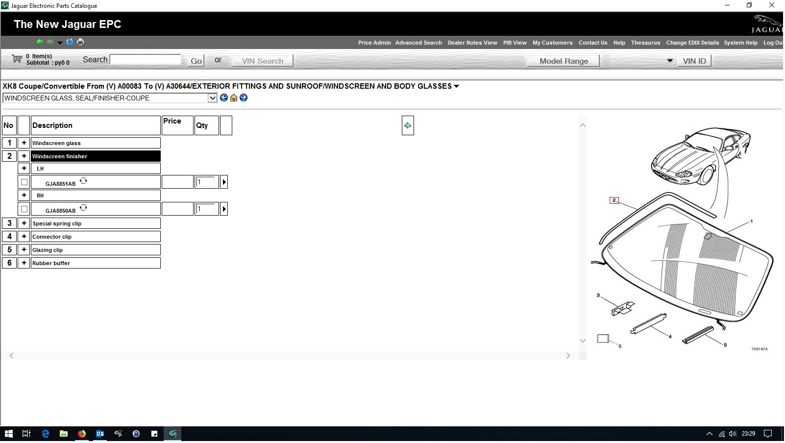

Likes: 17,016
Originally Posted by norfskate
..... the windscreen seal for example is made of at least three different parts (one of which I need), the painting guide simply refers to the lot as the “finisher” ��
CORRECT - the seal is a metal/rubber bonded composite supplied as LH and RH sides. There are no sub components available. The fronts are £175 each.
Window seals issues / help identify parts?-windscreen.jpg
(double click on the image to enlarge it)
The door waist rails are a similar construction and are a far more usual fail than the front or rear screen seals.
