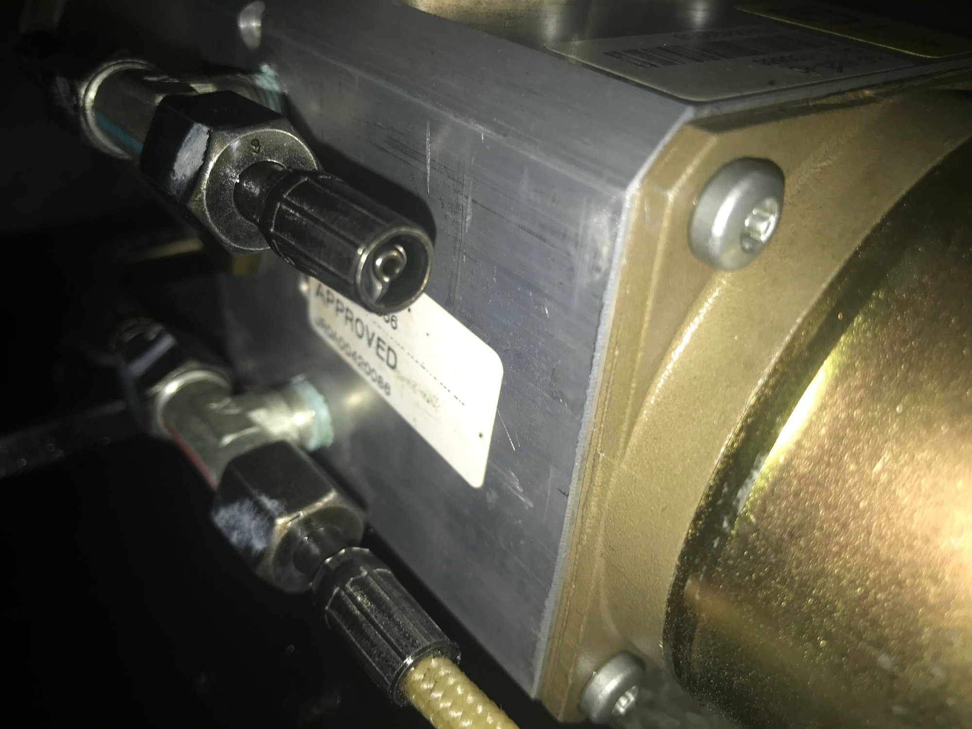

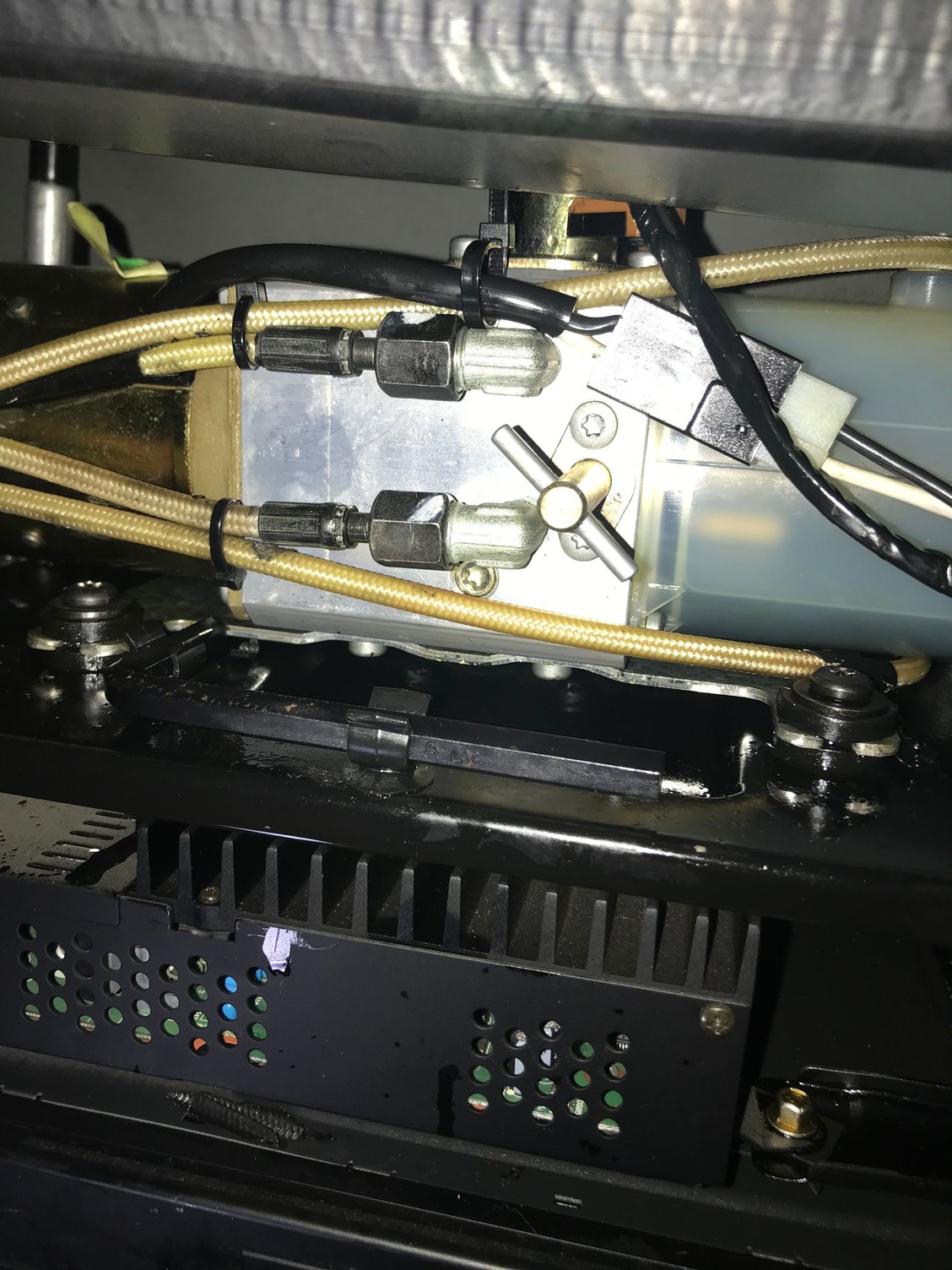

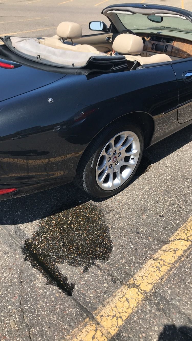

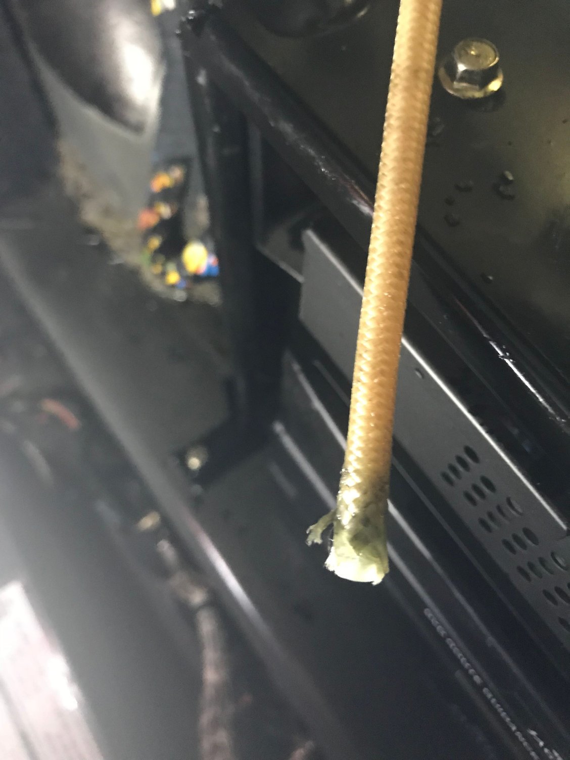

here are some pics for certainty. My mechanic is talking about using a repair kit, but that isn’t something I’ve heard about.
Stupid wuestion..but there’s no way to just reconnect the line eh? I’m really considering just replacing the four lines when I’m up north so my car-savvy brother-in-law can help out. Could I just replace the one hose to save some money?? I couldn’t find that option on top hydraulics.
Location of leak
Pump from trunk side
Line that blew out
Far side of pump, line on top must have blown out.

using repair kit is not advisable- you can get better quality, higher pressure rated replacement RAM hoses for about 400 from either Cabriolet Hydrauics (I used them) or Tophydraulics - several members have had great success with them.
If the RAMs are leaking, tophydraulics can rebuild
It is not a difficult job to replace the RAM hoses
