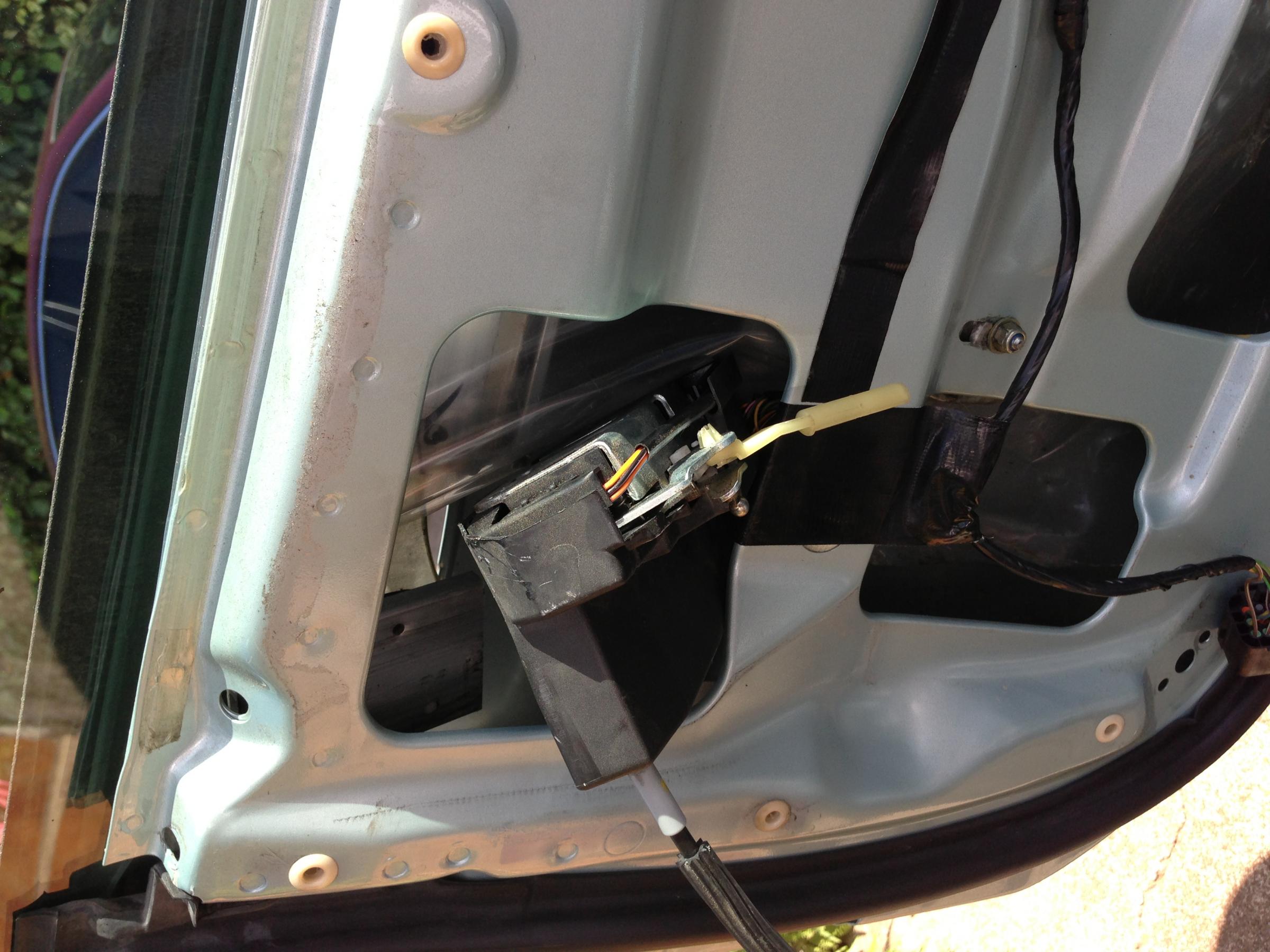

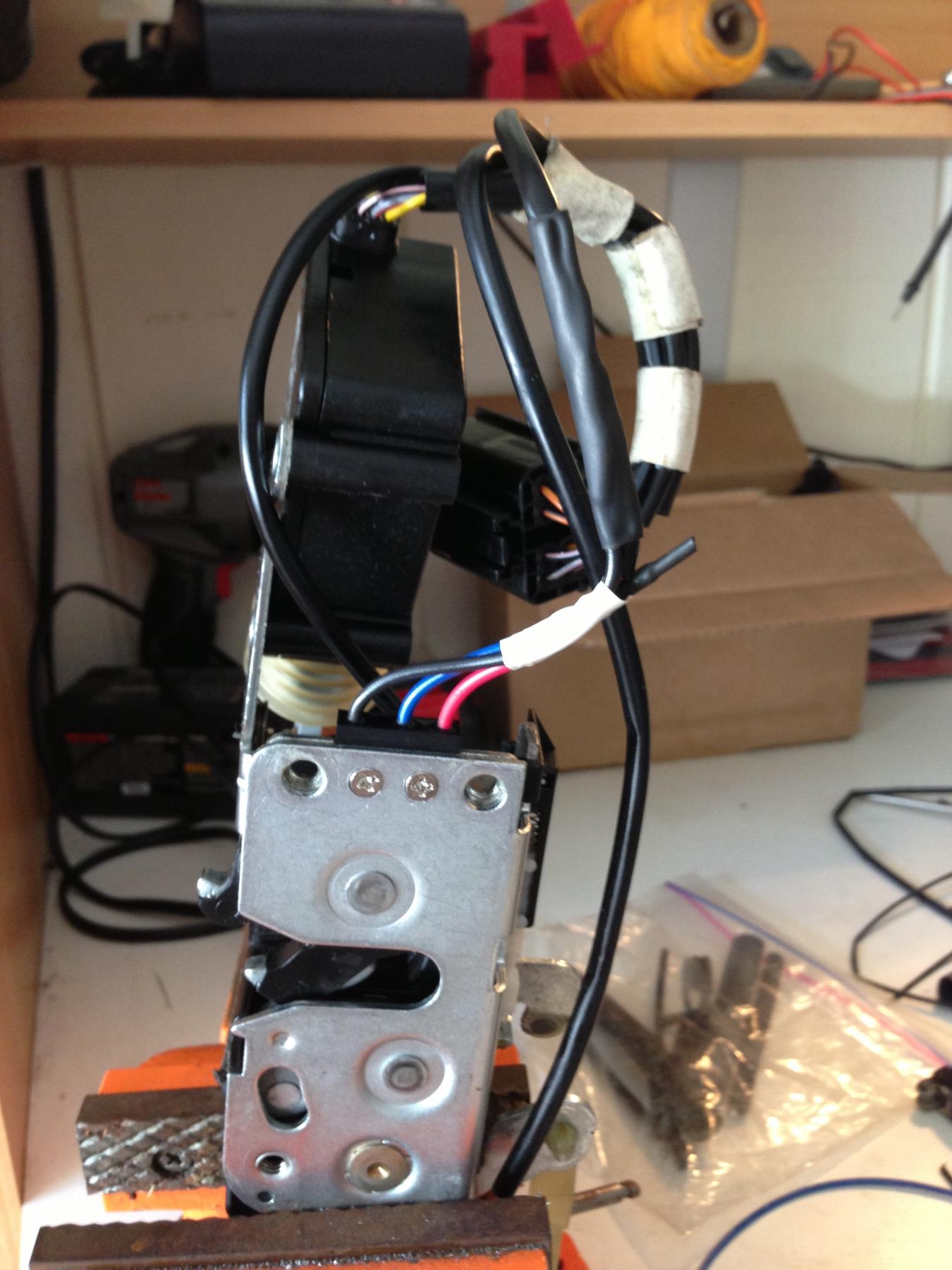

Attached photos here for all to see.
Be very careful when setting up the micro switch and bending the lever. You want the switch to activate just as the door latches, this tells the window to go up.
I attached my VOM to the wires and activated the lock by hand to test, give it a try, after actually seeing this it will become apparent. Be sure to secure the switch when testing as the setting is somewhat delicate and if the switch is loose you may be off.
The old switch just prys out, I found that a #4, I think, countersink screw worked well to reattach the new switch, the plastic switch housing is just about correct for it to thread through. You may have to run a drill bit through to make it fit with out binding. Be sure to counter sink the screw heads, I used a 1/4" drill bit. This side of the latch press against the door frame and if the screw heads are proud the latch will not sit correctly.
JagRepair.com - Jaguar Repair Information Resource see this link at the end to understand how to test the switch with the VOM.
Photo 2 is the new switch installed, photo 3 is the new switch wired, photo 4 is the old switch removed showing lever orientation, photo 5 shows the lock orientation to get out out of the door. Getting the lock out can be a PIA, it's one of those things that when you get it correct it just slides out, don't try to force it, it will come out when orientated correctly. The window must be all the way up.
Attached Thumbnails Window setting after replacement-handle-connecting-rod.jpg   Window setting after replacement-new-switch-installed.jpg   Window setting after replacement-new-switch-wired..jpg   Window setting after replacement-old-switch-orintation.jpg   Window setting after replacement-removing-door-lock.jpg
