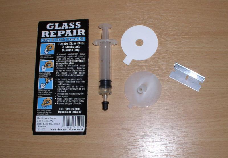

Steve,
The kits usually come with an industrial single edged razor blade as shown on the right:
Very sharp but a 'use once' tool on glass to avoid scratching. Plenty of sources on eBay UK.
If the chips are very small, cleaning / superglue / trimming could well be just as effective.
