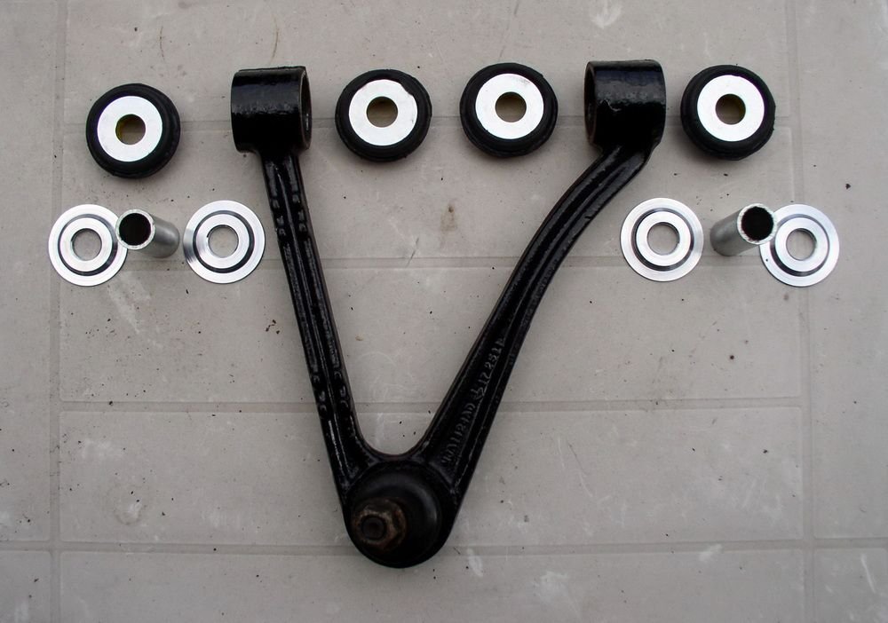

My worst experience with one of these (and there's been a lot) was four days of alternate soaking, heating and hammering.
This is the standard bushes:
Yellow with a squarish shoulder will be polybush.
