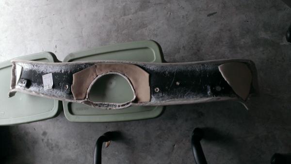

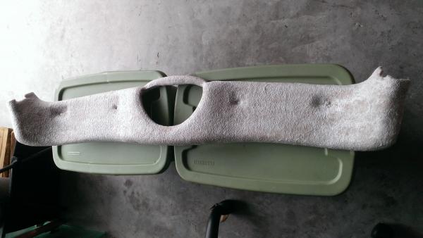

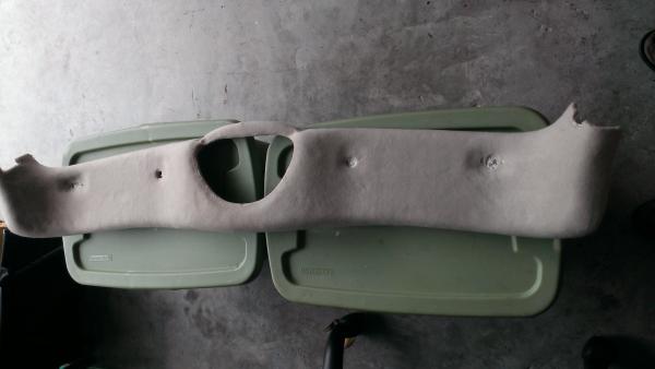

I removed the header panel to fix the loose material from the crumbling foam.
It was pretty bad as expected. First step was to remove all the old foam like I did from the A pillars.
The panel itself is some kind of fiber board. Here it is scrubbed clean. I will let it dry overnight before I apply adhesive to it.
I handwashed the fabric to remove the old foam rubber bits. I used a little dish soap and cold water. Results were same as the A pillars. Good enough to reuse.
I went to the fabric store and bought some headliner material. Got the end of a roll for $6.
This stuff already has fabric on it but I intend to cover over it. I covered the panel with adhesive and applied the fabric.
Here is the cleaned material with the covered panel. One thing I discovered is that the panel and pillars are actually Oatmeal color while the rest of the interior is Cashmere. Are all XK8s like that?
Next I covered the new material with adhesive so I can bond the old material to it.
Finally I applied the old material and smoothed it out. I ironed it before applying. I also snipped a piece of the old material from the back and used it to cover the cheap looking plug for the manual latch release. All looks great now.
Before I reinstalled it I took some of the scraps of the new headliner material and fixed them to the inside of the panel for sound deadening and to act as a "sponge" should the latch lines ever leak.
Attached Thumbnails Working thru issues on my newly acquired 04 XK8-rothwell-5131-albums-2004-xk8-7693-picture-wp-20130824-003-20000.jpg   Working thru issues on my newly acquired 04 XK8-rothwell-5131-albums-2004-xk8-7693-picture-wp-20130824-004-20001.jpg   Working thru issues on my newly acquired 04 XK8-rothwell-5131-albums-2004-xk8-7693-picture-wp-20130824-005-20002.jpg   Working thru issues on my newly acquired 04 XK8-rothwell-5131-albums-2004-xk8-7693-picture-wp-20130825-001-20003.jpg   Working thru issues on my newly acquired 04 XK8-rothwell-5131-albums-2004-xk8-7693-picture-wp-20130825-002-20004.jpg

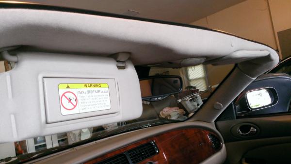

Forgot to add a pic of the finished header panel installed.
Attached Thumbnails Working thru issues on my newly acquired 04 XK8-rothwell-5131-albums-2004-xk8-7693-picture-wp-20130825-010-20009.jpg
