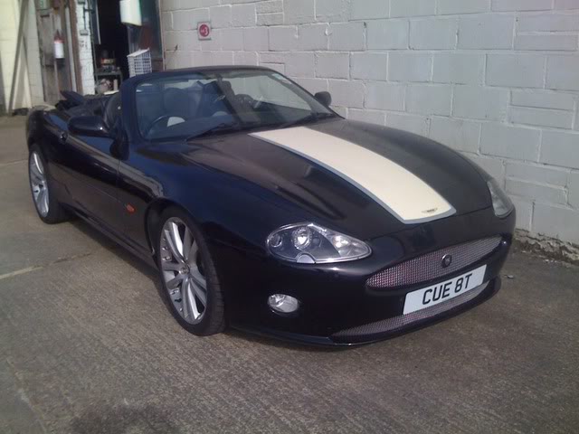

Default Wrapped XK
Thought I would start a new thread as people were asking questions on here and via email and I did want to hijack enderles thread

Originally Posted by ccfulton
I'm on the fence about the matte look, but the wrap is an interesting idea. What do you think of them compared to a respray? Do they hold up? Cost effective?
This is a FAQ, as for cost, around 1/2 the price of a respray, guaranteed for 5 years is the norm, light scratches are easily removed with a hot air gun. If you make a big scratch and go through then the same applies to paint, you have to get it re-done.
This is my convertible I bought recently

The joys of a wrap is you can take it off, I have removed the rear section as I am changing the rear bumper to the Verendum style with the seperate diffuser which will be wrapped in carbon effect
As you can see this car is originally Platinum Silver

The only problems with wrapping is your confidence in your paintwork, e.g. if you have had some accident damage and the bodyshop did not key the paintwork properly it will pull it off, however if you have full confidence you can remove the wrap very simply and change it, you can even wrap over a wrap if you wish, there are huge selections of finishes and styles, brushed metal finishes to carbon, snake skin, patterned, gloss, matt, satin....
You can really be different and when you get bored pull it off

Very nice. I rather like the stripe but snake skin might be a bit much.
Does it smooth out small imperfections or just contour to them?
How is it to take care of, just wash and wax? Or maybe wash and don't wax?
The ideas are flowing now, thanks for sharing.
