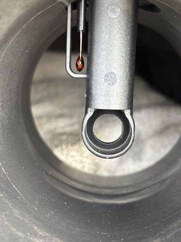

The downstream O2 sensors are on the way. They're supposed to be here next week.
This is what the sensors looked like when I took the unit off with the 2 screws. I sprayed everything with some MAF Sensor cleaner and put it all together. I've got to make a run to pick up the grandson from school in a little while I'll do that and then see if there's any change to the CAT monitor. I'm not expecting any.
