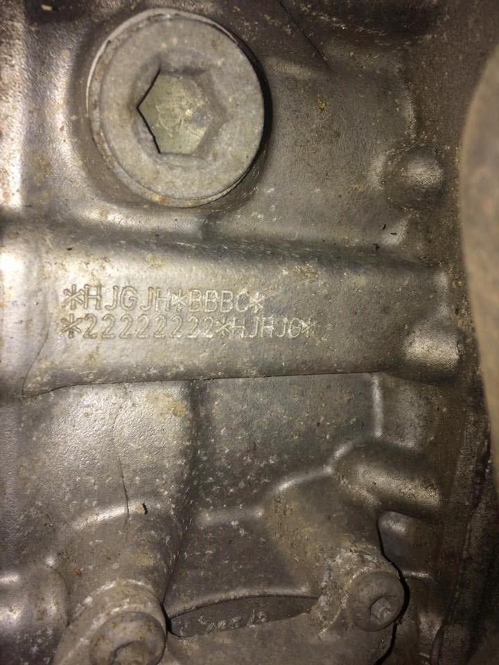

Hello, Colleagues. I was offered an engine, but I need 4.0 litre V8 for my XK8, '99. What kind of engine is it? I am just afraid of not getting the 3.2 one..
Thanks in advance!
