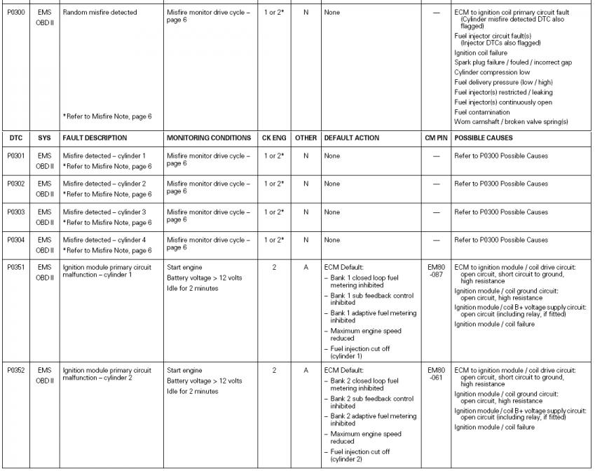

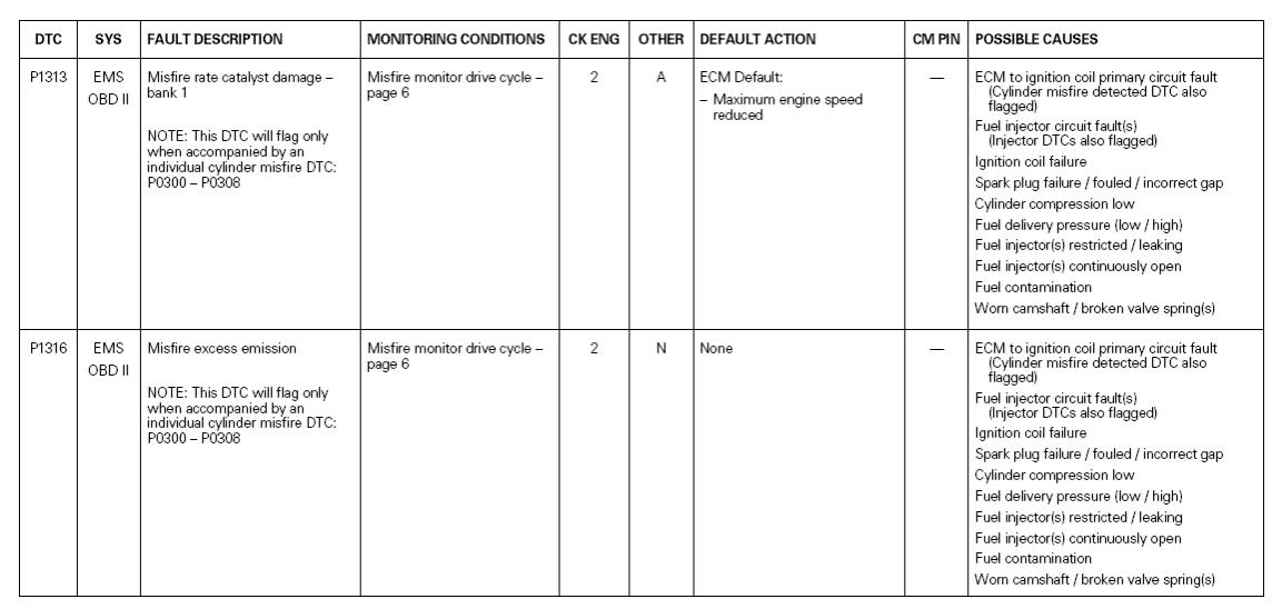

Just to help summarize your codes...
Attached Thumbnails XK8 Coil Problem-snippit-dtc-codes2.jpg   XK8 Coil Problem-snippit-dtc-codes.jpg
