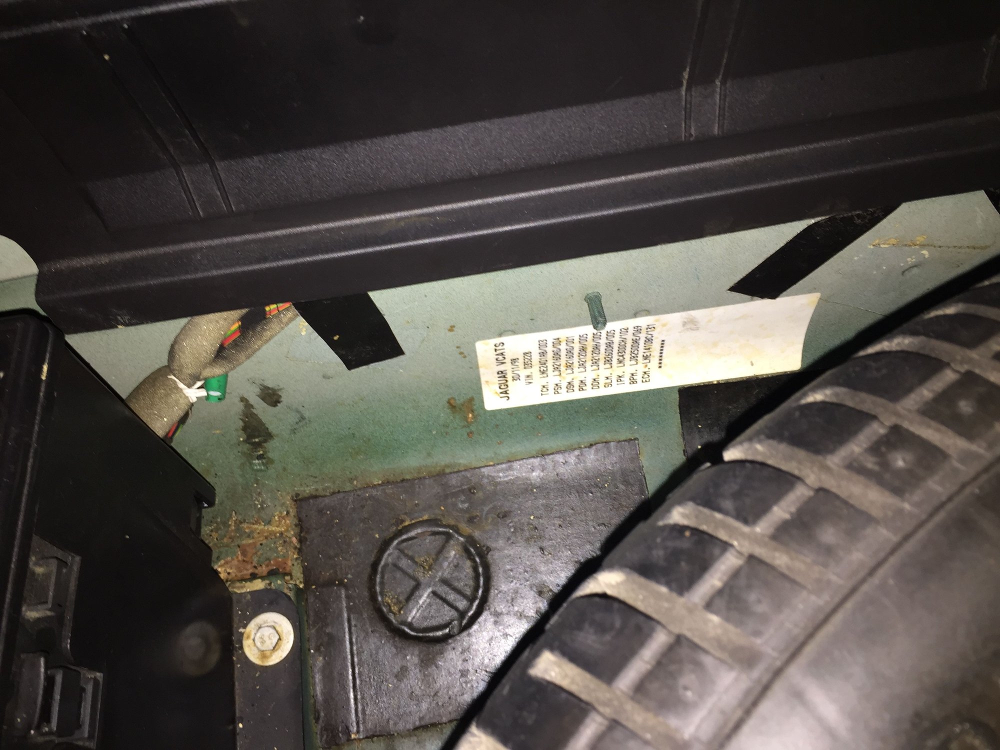

There are many problems with using replacement control modules in our car esp. from e£&y where sellers assure you it’ll fit your car.
Do you have the VCATs label in your car trunk that lists the module you have? Pic below

Couldn't find that sticker. I ordered new module for drivers seat but I guess I need some programming tool... any suggestions?
