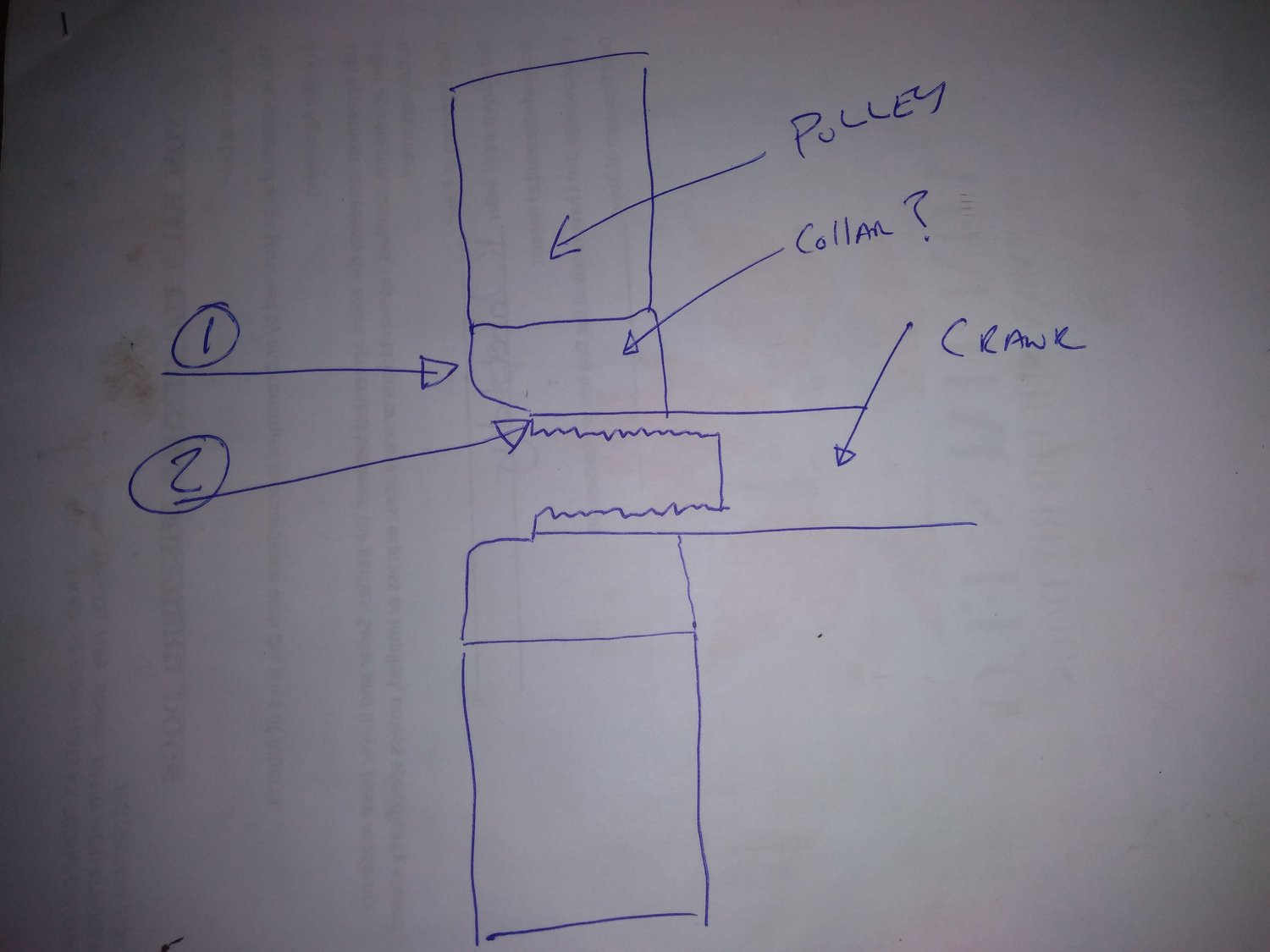

lm scared
l have removed the balancer pulley bolt using the motorcarman method with a 4' extension.
lve cleaned out the M8 threads with a tap.
The concern i have is with the ''button'' in my universal puller, because its a cone im worried it may flare the end of the crank. ls this Ok to use? Would it be better to find a socket or something that is just smaller that the ID of the crank?
Sorry about the ''scale '' object.
Also, what about a little bit of blue spanner to help it out?
Thanks ,

Put another way, which face is it safe to apply pressure too, 1 or 2?
Thanks

The collar (split cone) will follow the damper for a bit. Then you SMACK the assy and the damper will dislodge from the tapered collar.
The part you push against is 2. (the end of the crankshaft)
Thanks for the details MCM thats really helpful. Without wanting to come across as rude i ive seen you post that PDF you have kindly posted many times. The problem is unless you actually HAVE the adapter, its pretty useless, no dims, no indication of what face is safe and whats not
