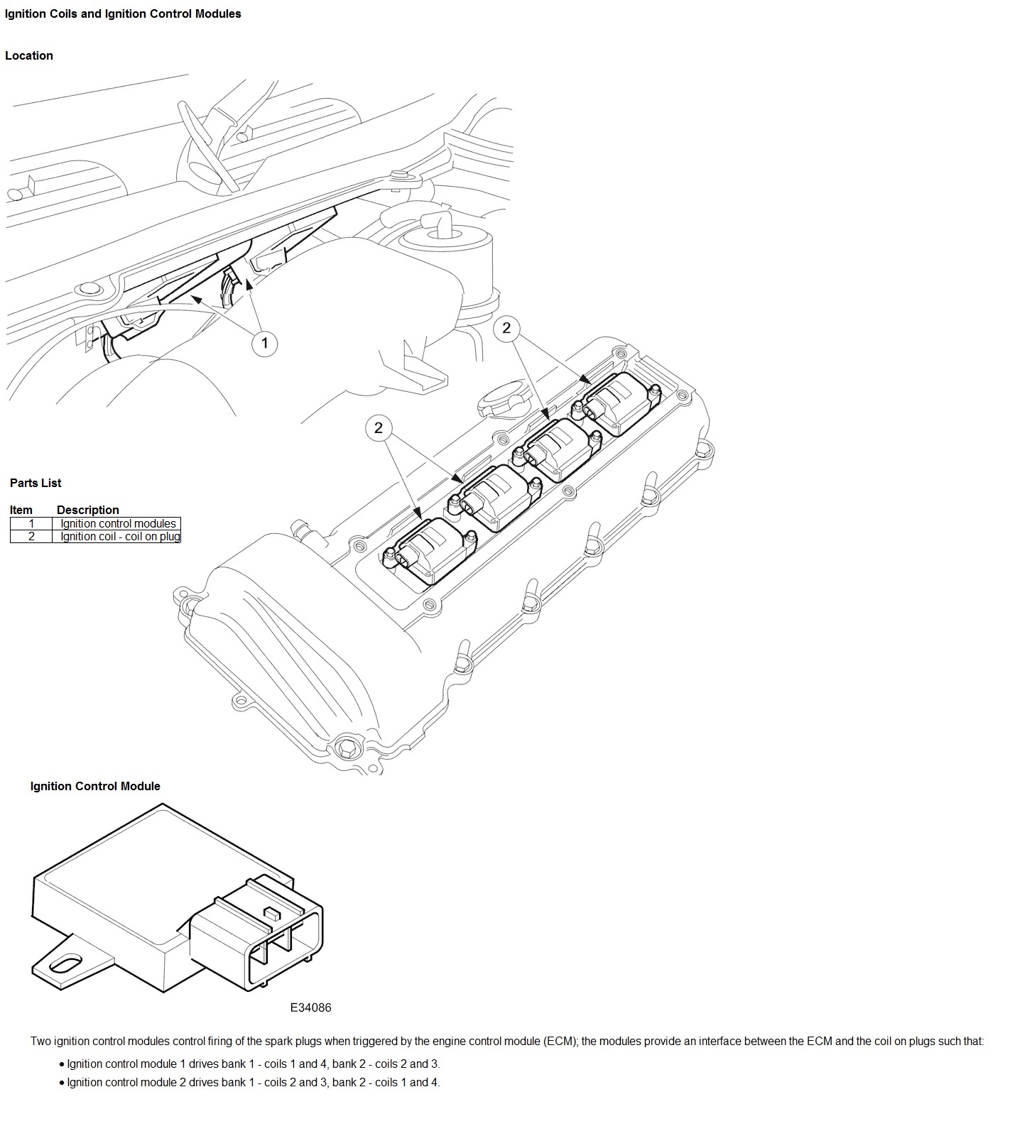

Hi all
Still battling with my new 97 xk8 going into reduced engine performance as per my previous post.
The problem now appears to be an ignition control module.
Question
Where are they located, I believe they are mounted on the firewall
Does the throttle body have to be removed to access the module.
It is my intention to swap the modules over and see if the error code changes.
Does any body have any information that may assist me
Thank you for any help
Kind regardsAlan
Old Apr 18, 2013 | 04:33 AM
Is this still related to the P03xx misfire codes?
Here's the Ignition Module (item 1) locations:
Ignition Coils have many more reported failures than Ignition Control Modules.

FYI, found this info from :
jaghelp.com: P0351, P0352, P0353, P0354, P0355, P0356, P0357, P0358 on a Jaguar XK8 (1997 - 1999)

In the North American Models, the ignition coil modules are located inside the false bulkhead near the brake master cylinder.
I have not seen a RHD car here so I can't comment except to look in the electrical guide for COMPONENT LOCATION. (it will tell you where to look)
