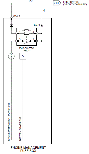

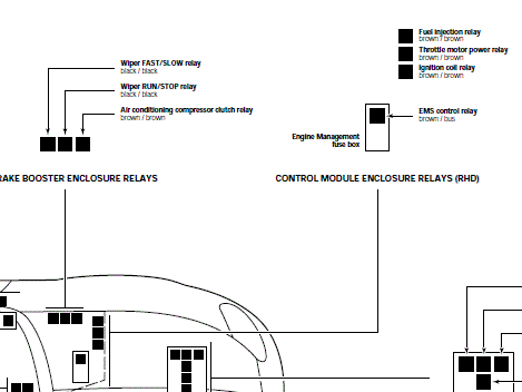

Can you confirm which relay is missing its switched ground: - is it this one in the Engine Management fusebox?:

HI, yes it's that one, I put an earth on it and it operates, but if I unplug the starter relay (which isn't operated) the EMS relay stops running??? weird or what!

Hi,
In a normal situation, the ECM controls the EMS control relay, and for whatever reason, the ECM is not doing so here and the engine management systems remain shut down.
I would check for codes:- there may be an issue with the security system e.g. the key not being recognised. Do you have another key you can try?
Check also that the inertia switch hasn't tripped. It's in the passenger side (RHD) fascia fusebox. See frankc's post here:
https://www.jaguarforums.com/forum/x...1/#post2128787
The starter relay is fired by the BPM, but there's a feed back to the ECM which might detect that the relay has been removed (12V via relay coil missing).
