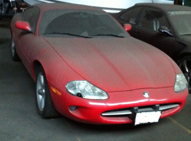

I've decided to create a thread whereby I can update the progress on the restoration of my 1999 XK8. To date I have acquired;
1) All replacement suspension components including struts, mounts, rotors, calipers, all universals, stainless break lines, all bearings.
2) Water pump, aluminum thermostat housing, new thermostat, etc.
3) Tensioners', etc, etc. The motor was replaced under warranty with a second gen but I will change the tensioners out for third gen anyway.
4) Removing Transmission in the next week and then starting on a complete overhaul of the body.
I will continue to add pictures as the work progresses
Open to suggestions and comments and look forward to same. Have already picked up a ton of ideas including lamp upgrade that have led to the purchase of a number of goodies
Thanks in advance.

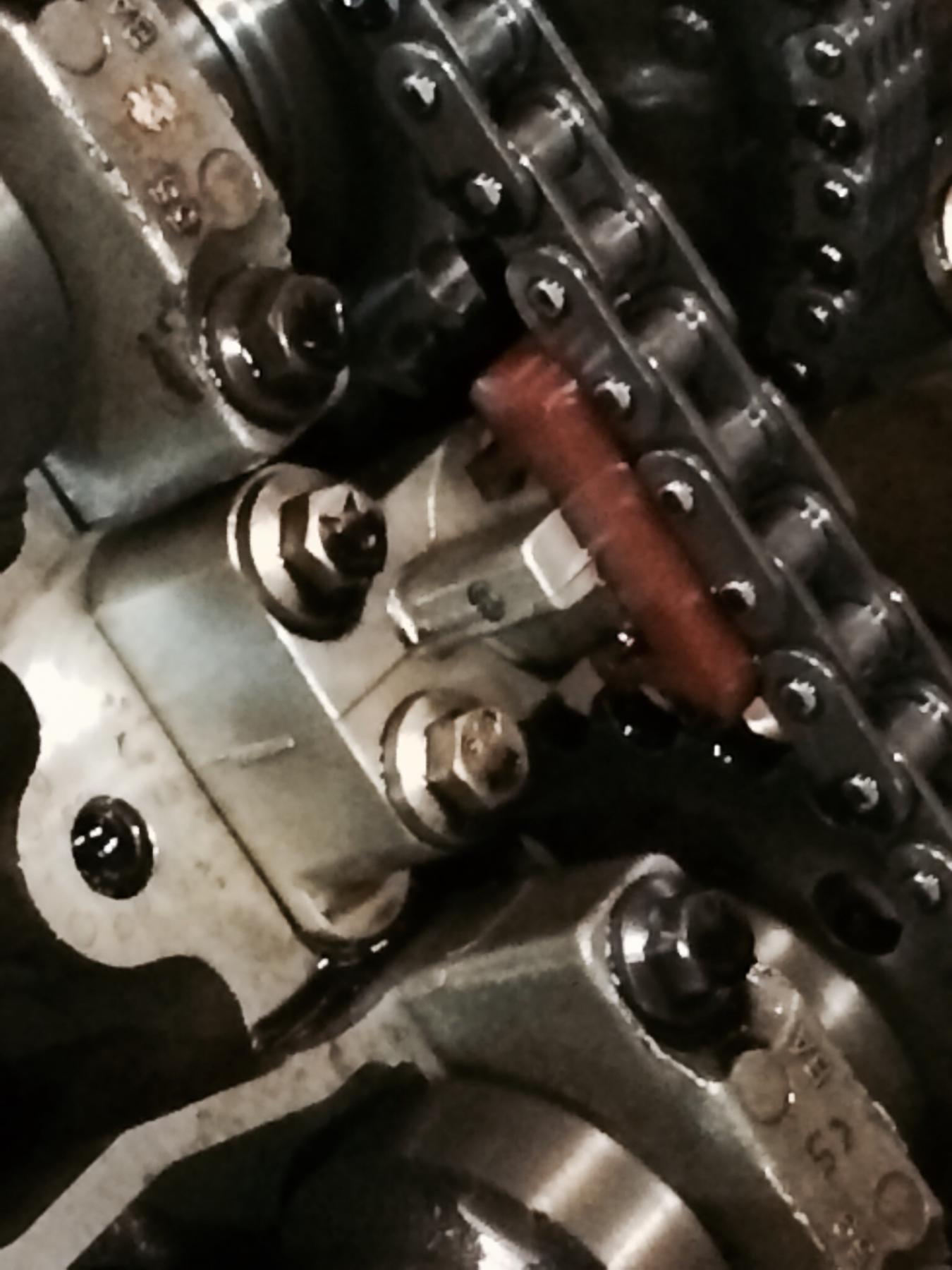

Default Tell me this tensioner is new gen please?
Just took valve cover off. Is this a new metal tensioner? Fingers crossed please let me know your thought ?

You win the prize, but what about the other side? There have been reports of only one being changed.

The other side as well. Great news now I can spend a little on some other things eh!

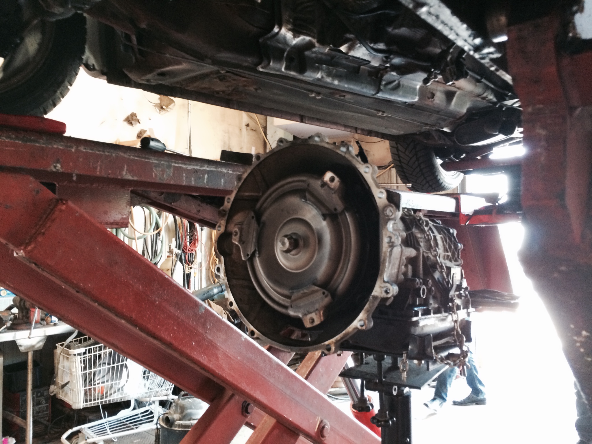

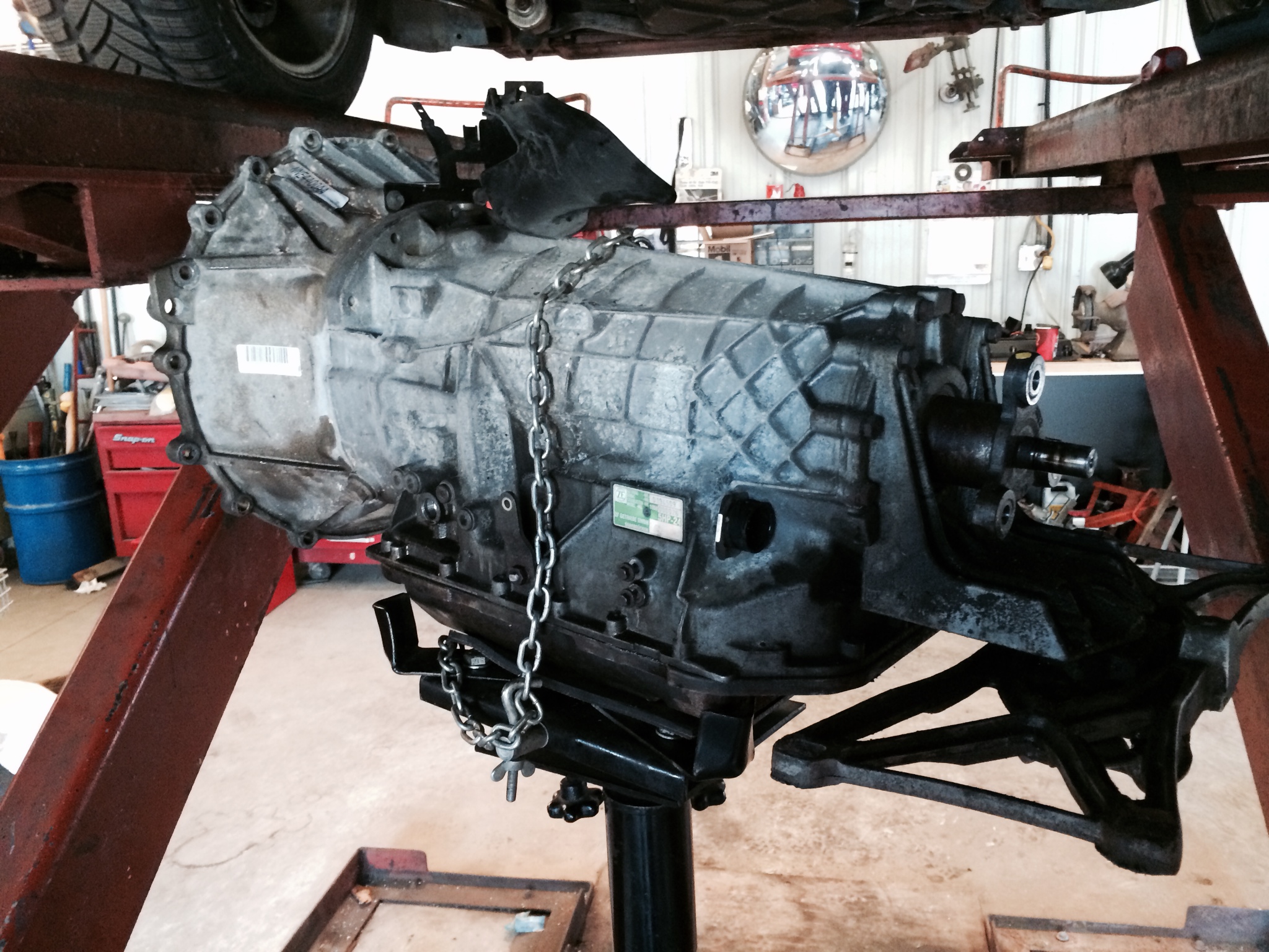

Making steady progress. Trany is out and on its way to the transmission shop

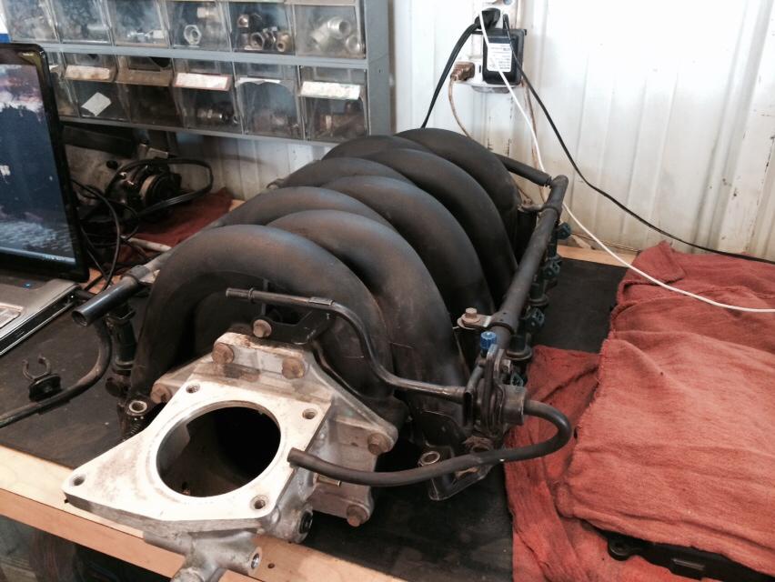

Default Starting on the intake
Changing the intake gaskets, valley pipes, getting a little help from the Bud Man
