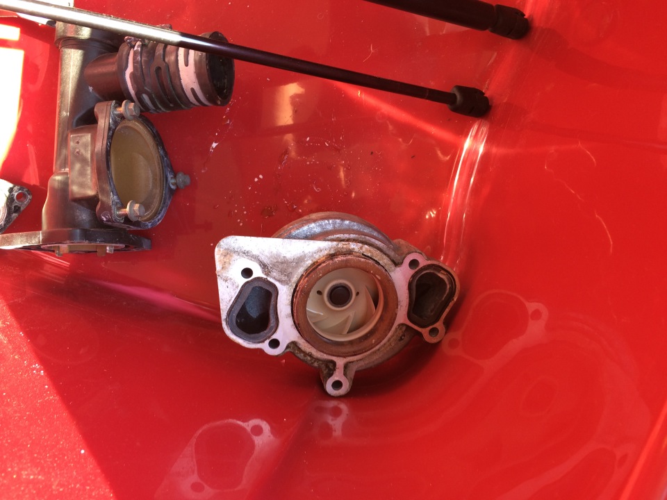

Default Water pump out
moving ahead removing the old water pump

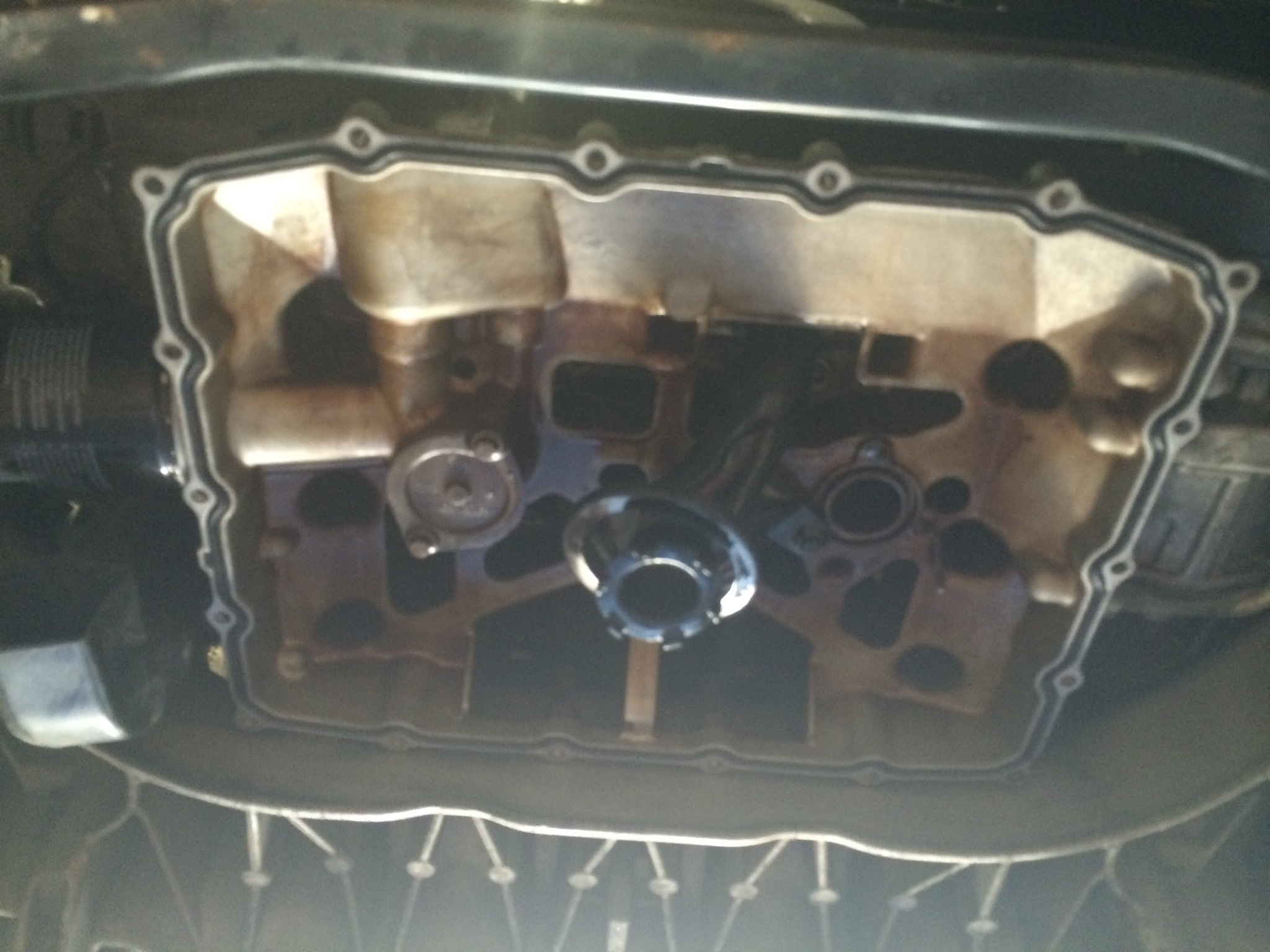

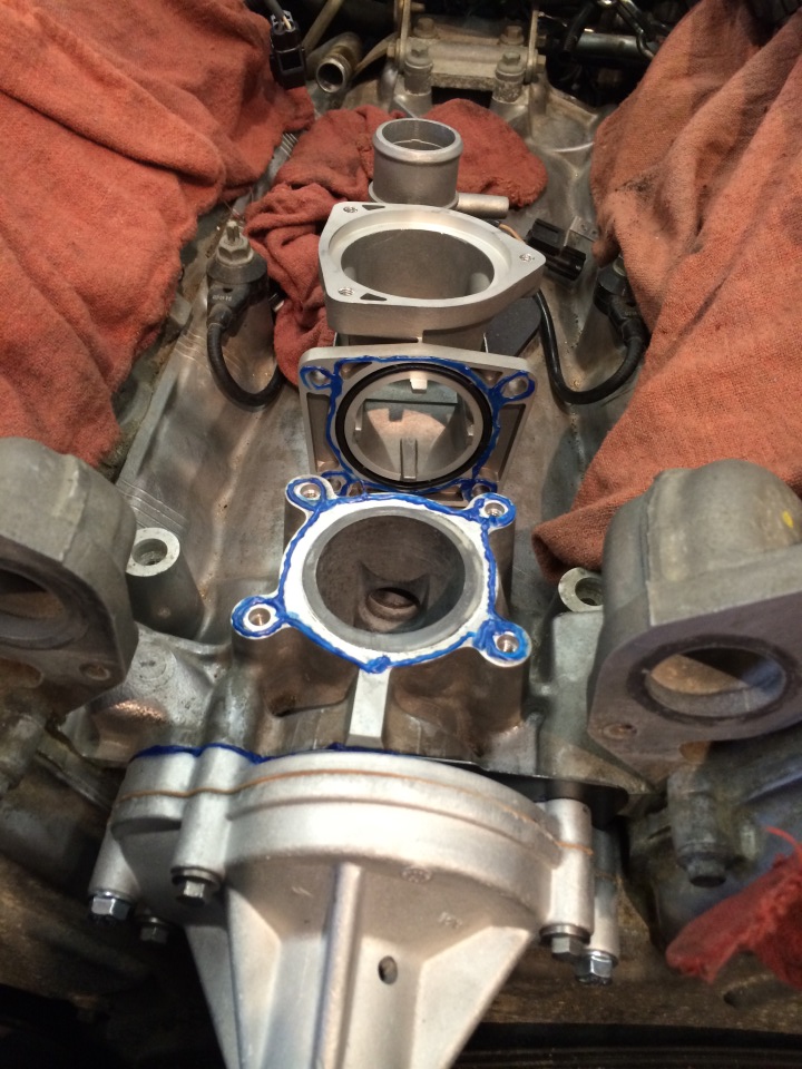

Default Water pump in
Water pump, fill housing, thermostat, thermostat housing, outlet pipe, new rad hoses, by-pass hose in. Changed the oil pan gasket and onto the rear seal

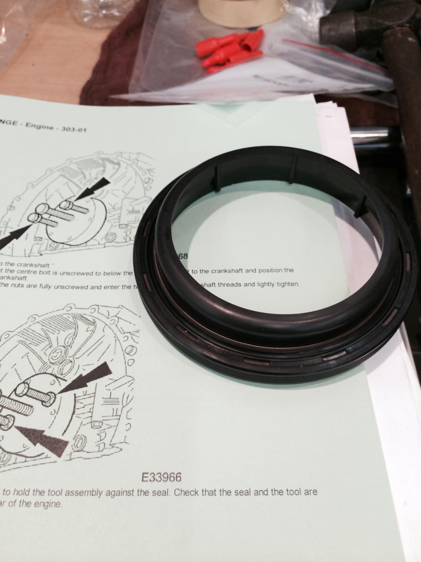

From: Sarnia, Ontario, Canada

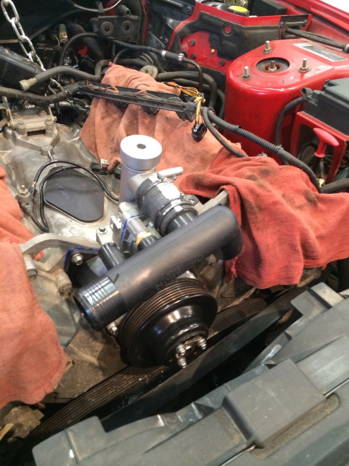

Making some slow but steady progress. New valley hoses installed, new knock engine sensors, intake reinstalled and rear crank seal replaced given the transmission is out

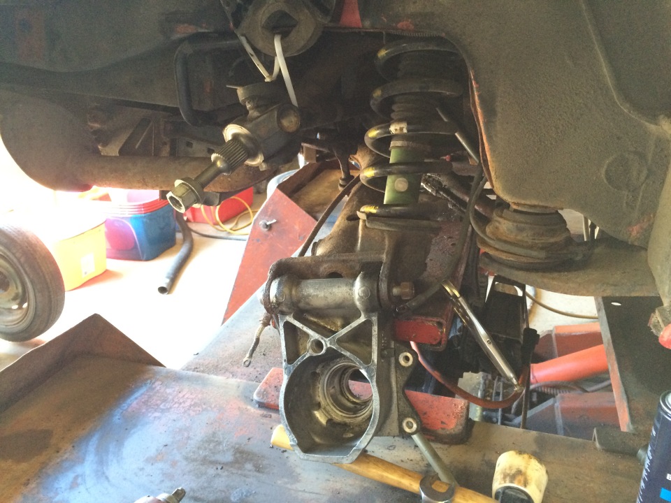

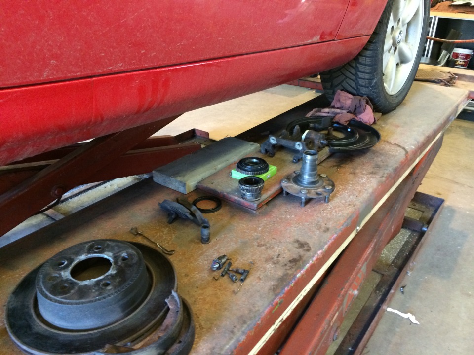

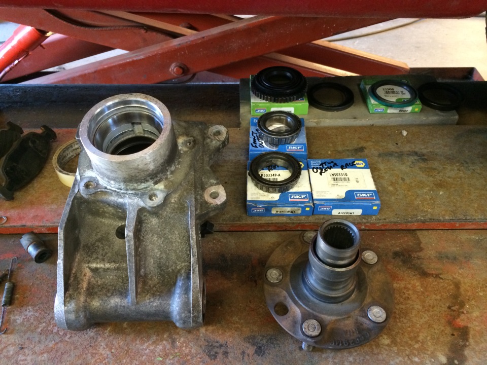

Default On the rear suspension
working away on a complete replacement of the rear suspension components

How many miles are on the odometer?
With the oil pan off it looks like it might have missed an oil change or two.
Perhaps a compression test is in order, if you haven't done so already.

The engine has 60K it was replaced under warranty for the owner (my Uncle that passed away) 110K on Odometer. It is a 2002 crate motor replacement according to the vin on the engine and the Jag dealer. Compression was checked before I started the tear down all was good. Thanks for the moral support its going to be a long haul

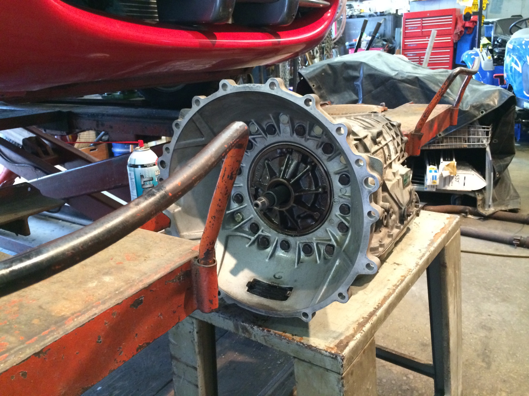

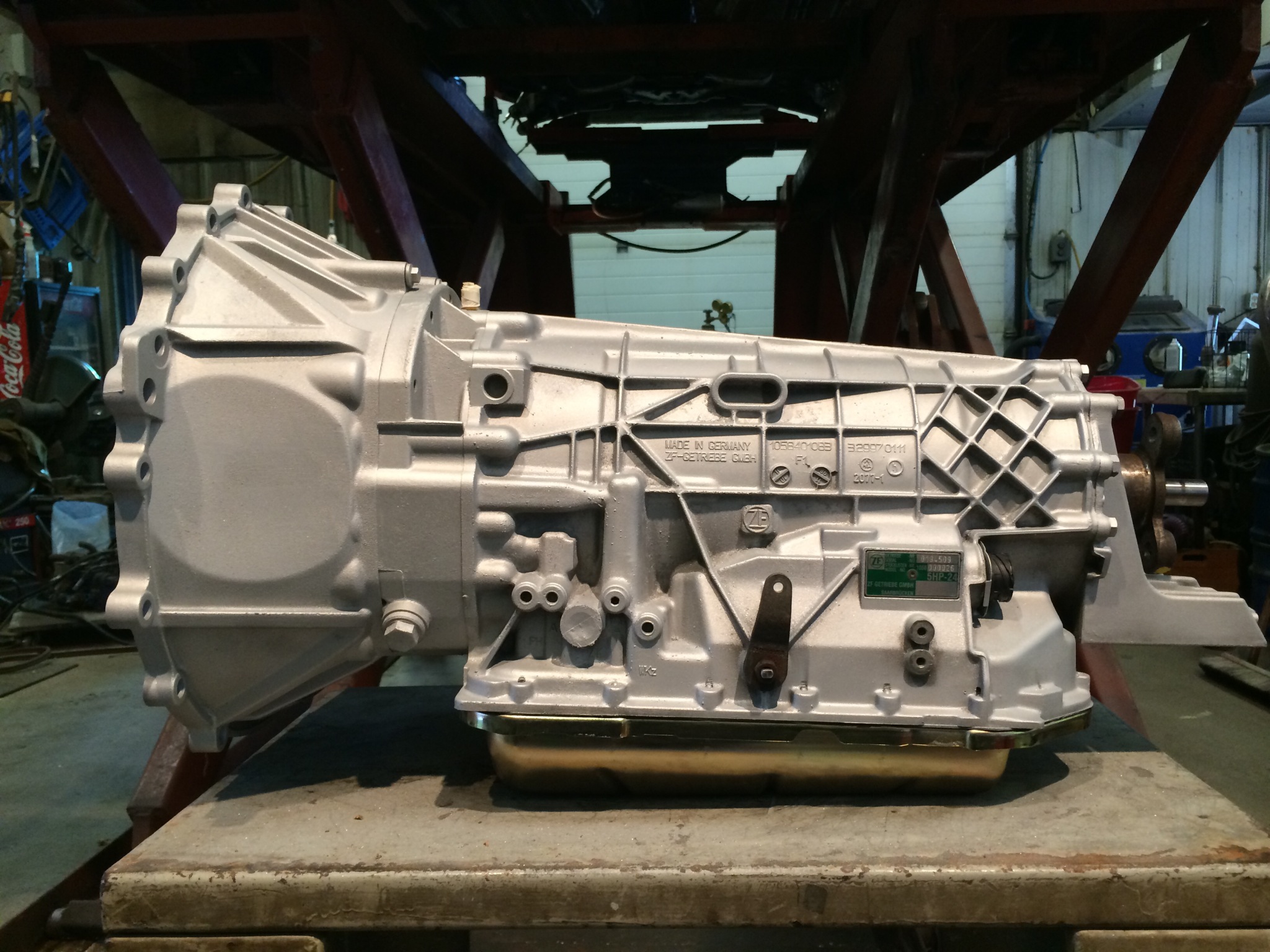

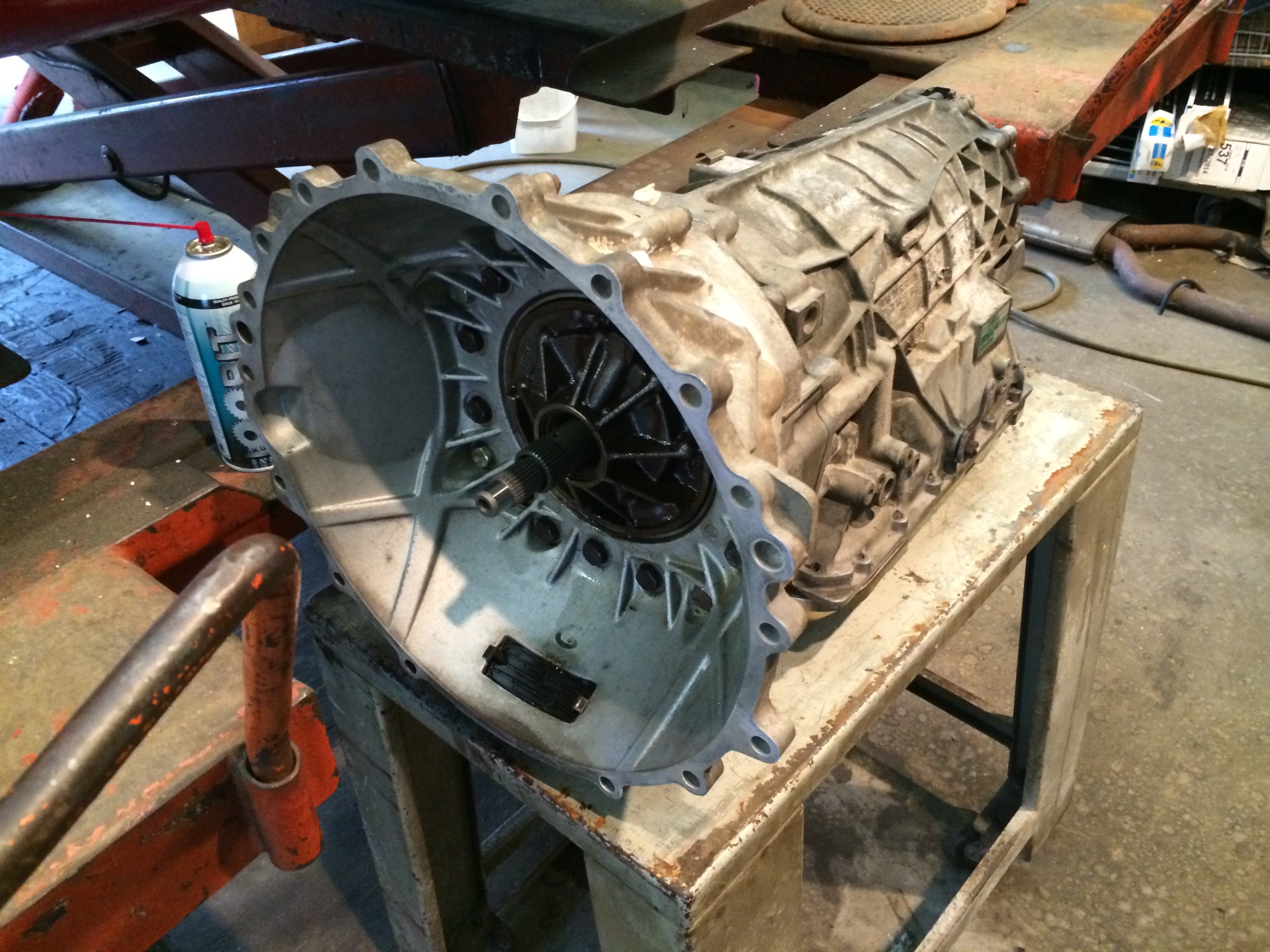

Default Tranny returns
Transmission completely rebuilt by local transmission shop. Mechanic older guy from Germany went through everything he had to do. A drum was replaced, all seals and clutch plates. I will be putting it back in a few weeks. Moving onto the suspension and coating the underside with POR-15

Default PlastiKote
Decided to refinish the trans before I pop it back in. Used PlastiKote Rebuilders' Caste Finish. Good up to 300 F.

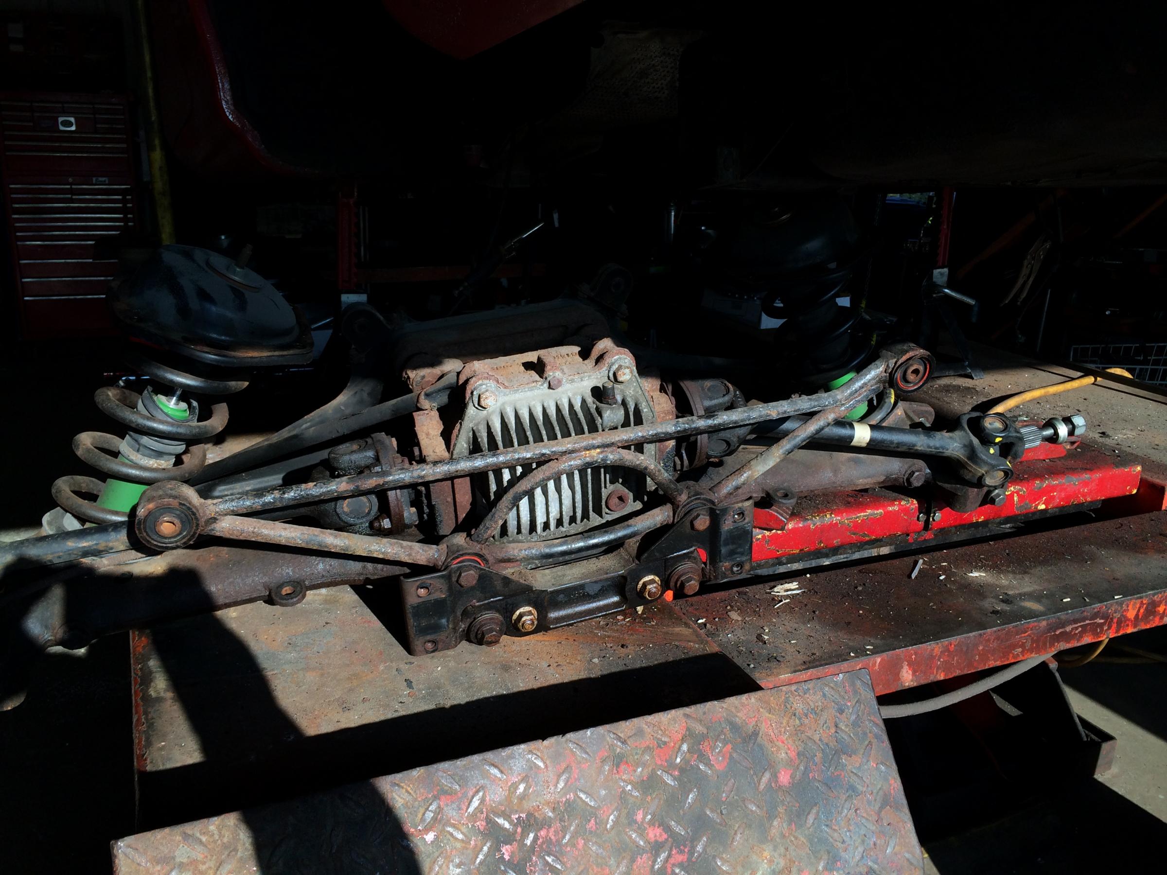

Default Dropping the Differential
Well changing out about 90% of whats in the back so decided to drop the whole thing. I have used sub-frame parts and another differential on the way. I'll post pics of the rear end rebuild shortly

when replacing the thermostat for the metal one you might want to consider either hex bolts for the rear bolts or cutting a slot in the bolts that a screw driver can fit into. that way if you ever need to remove it you can get at them with either a long ball tip hex wrench or a long screwdriver. just a thought .
