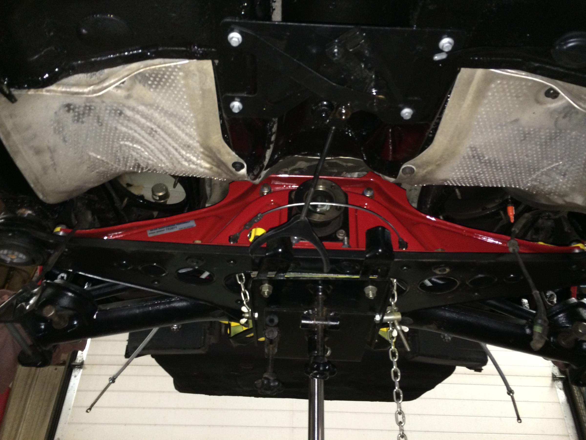

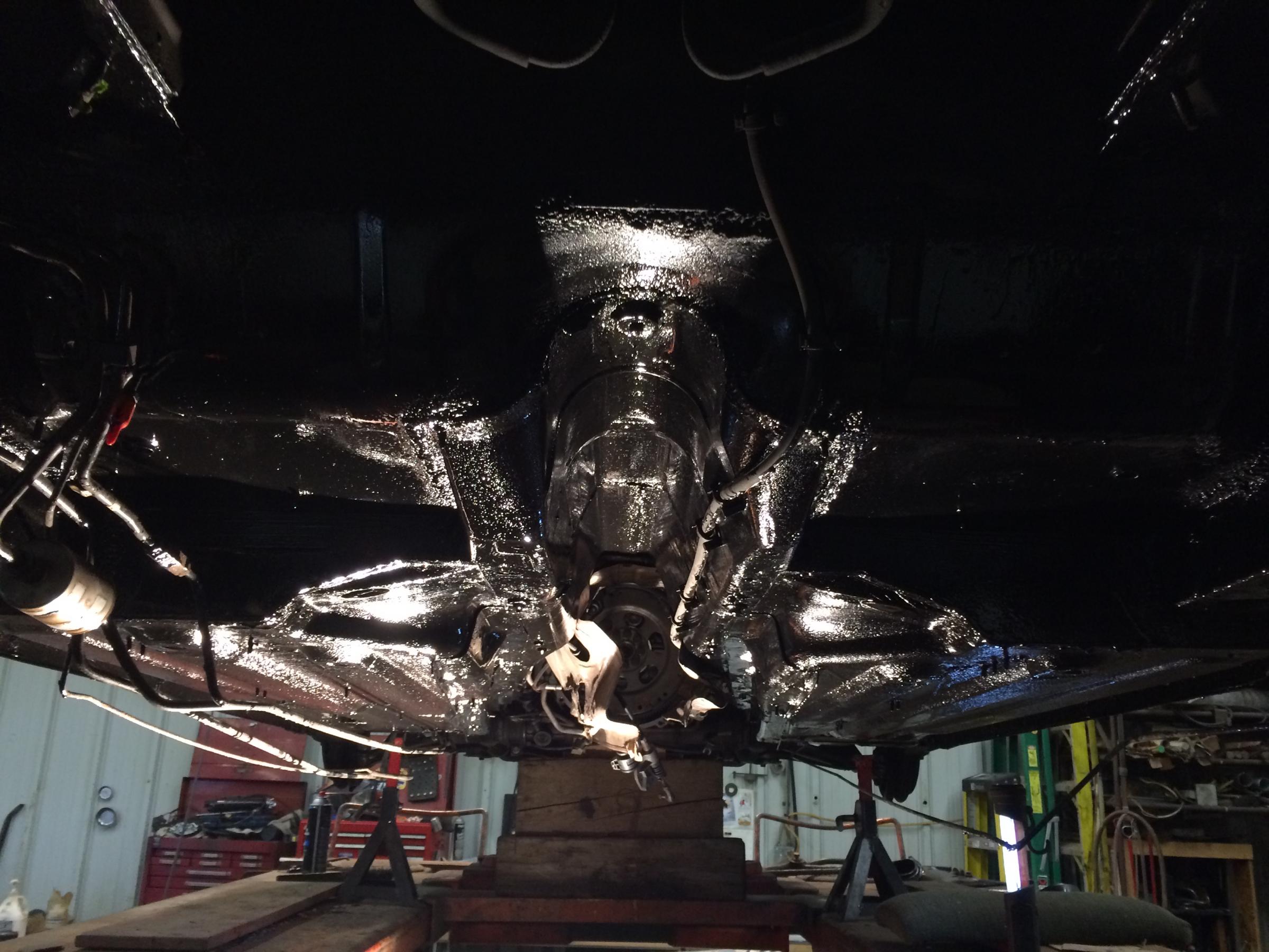

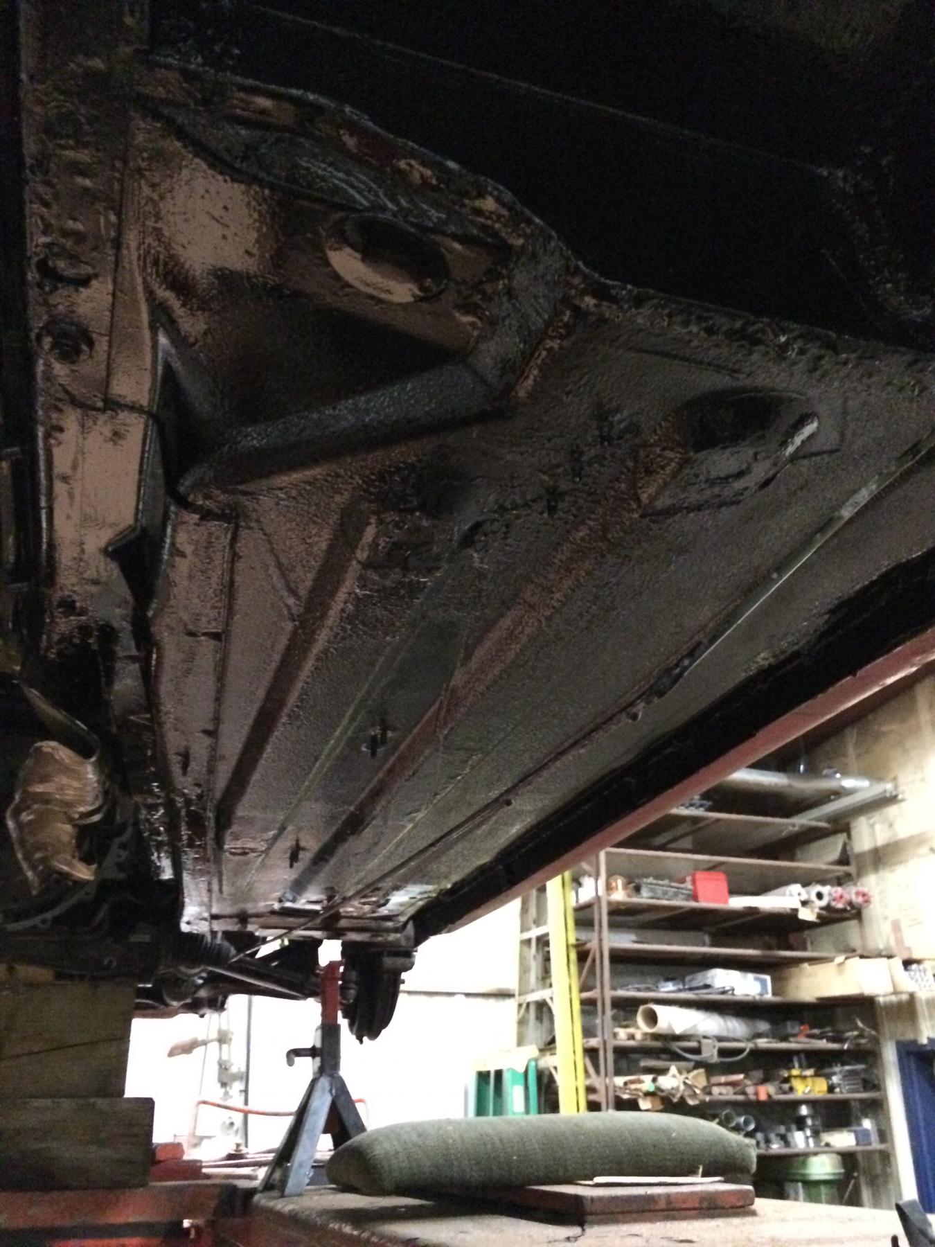

Default Rear suspension In

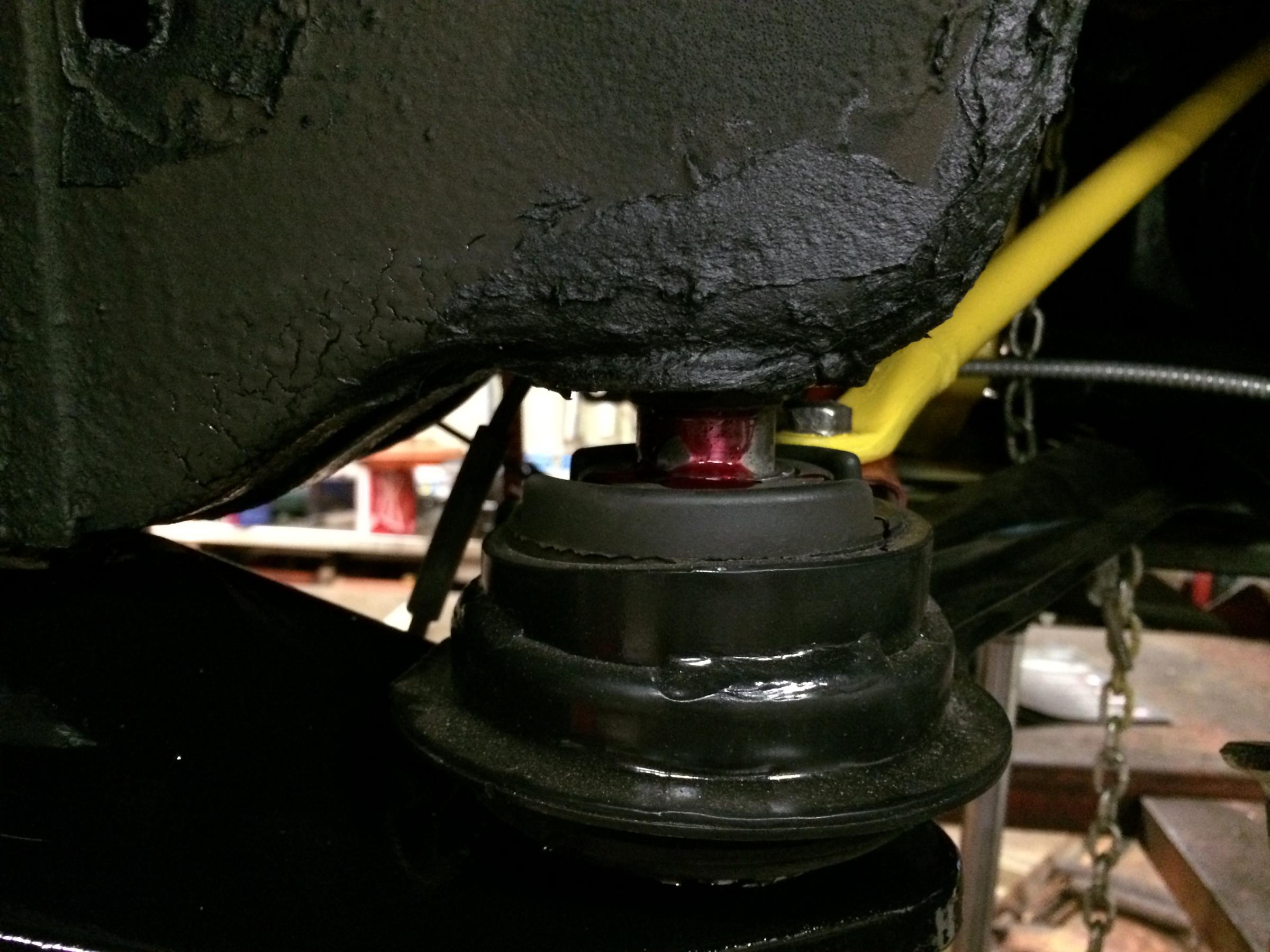

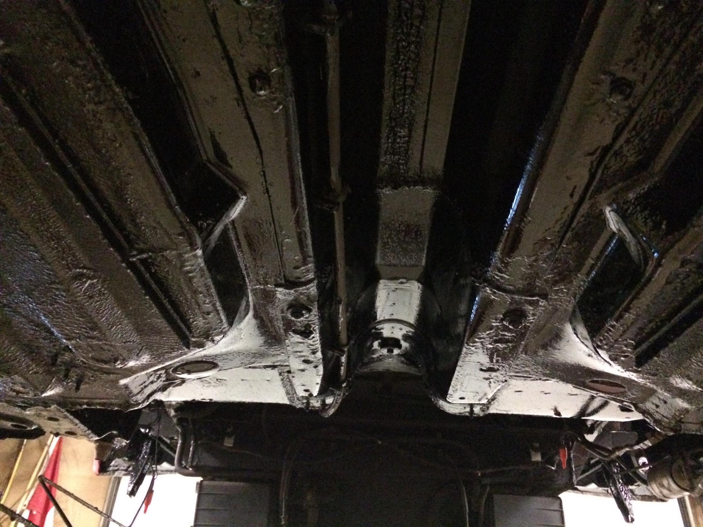

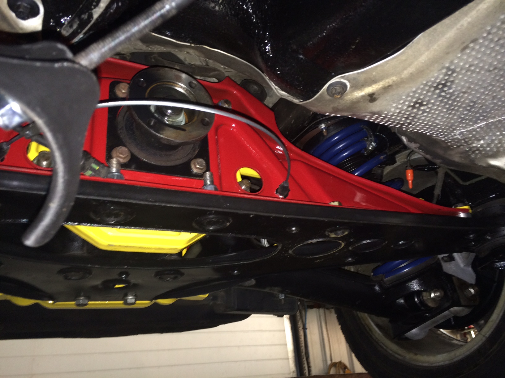

Finally after some playing about the rear suspension system is back in now to finish mounting the shocks, brakes etc. The entire bottom side of the Jags been finished in POR15

WOW, There are those of us that would call this a thing of beauty. Well done, detail is hard to hide.

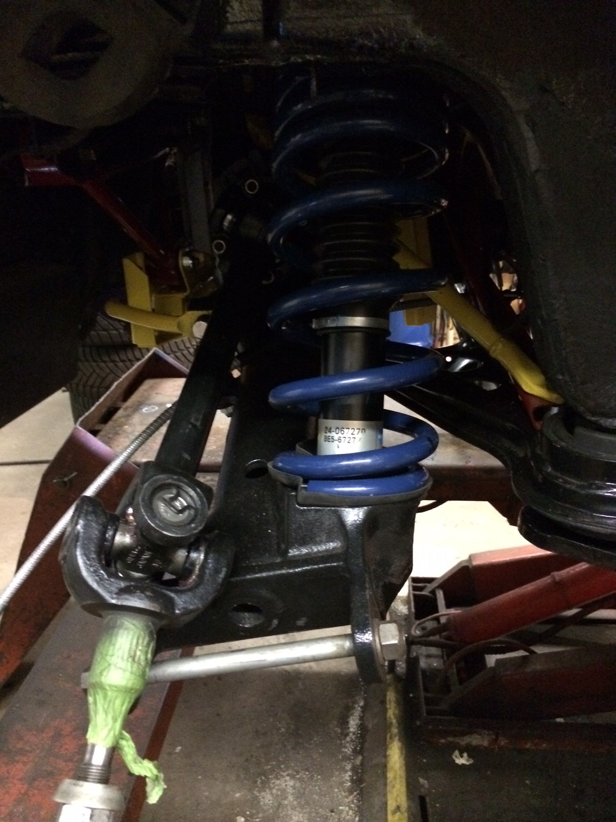

Moving onto the front suspension now that the rear has been completed

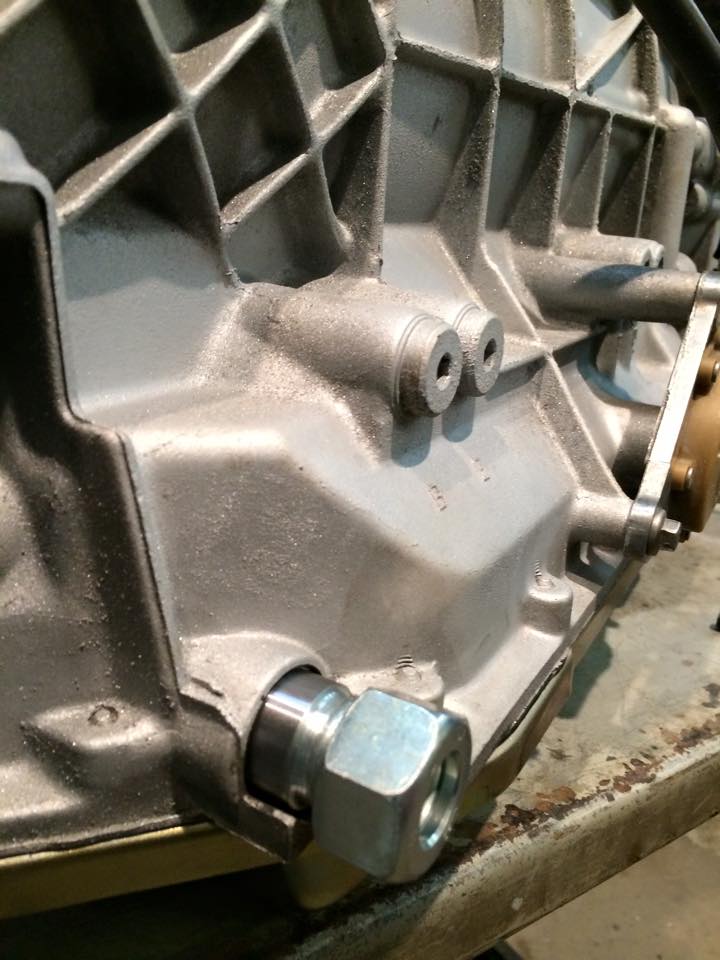

Default Trans In

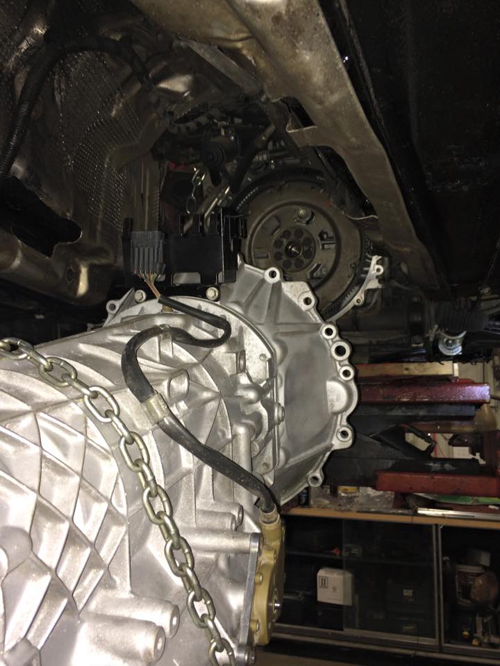

Ok so the trans went in on the weekend and I was able to install the new combination dip stick - fill tube from 5HP24 Dip Stick

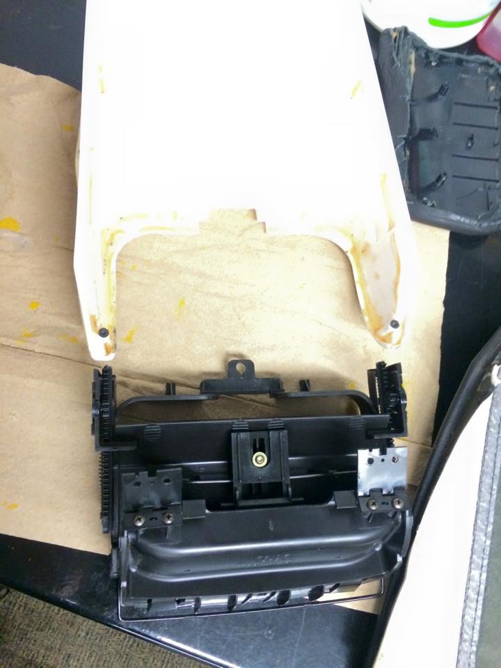

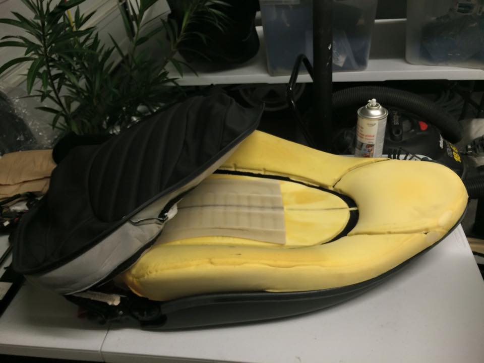

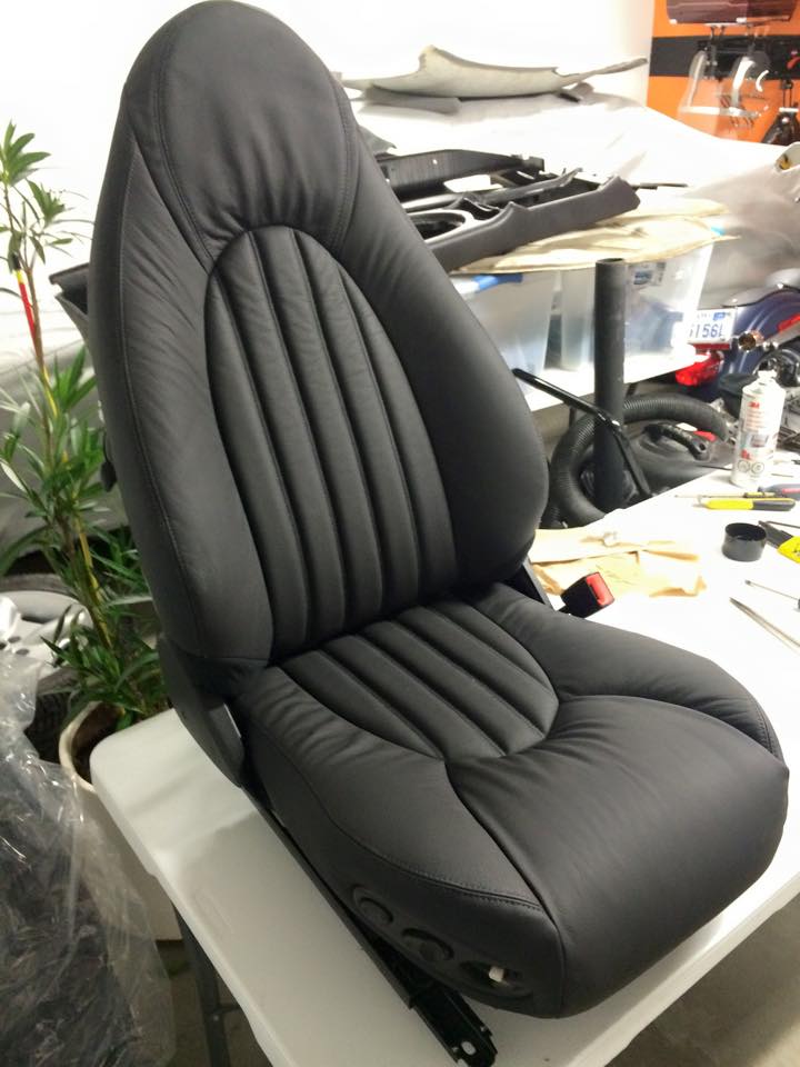

Took a break from working on the mechanics of the XK and decided to start on some interior work. Replaced the passengers side seat leather cover, next will be the drives and working on console parts.

Beautiful job. Did you recover the seats yourself? If so, did you have any guidance? My drivers seat on my 97 XK8 conv is in tatters. Thanks!
Thanks. Yes I did them. This is not a difficult task. The seat covers come from Convertible Tops, Headliners, Convertible Top Parts, and OEM Seat Covers , there are a number of posts on the forum on this, fit is excellent in my opinion. Just be careful if you in colder climate and attempting this work the plastic fitting, covers, etc become brittle. I have a fully heated garage so it all worked well.

I had my seats recovered. The photo appears to show the leathers is a little loose. When mine were covered we added extra foam to take up the "baggy" cover. We did this because of the original foam compressing over years of use. Mainly on the wear area's center seat and center back and head. Just an observation. I do not mean to imply any negative vibes!
No negative vibs taken, all good comments. I noticed that as well and will add some foam. Not sure what to add what did you? Unfortunately I threw out the old cap when I was making some room and have learned early on not to do that any longer. I am keeping everything to the bitter end now. Gas shield I will order today. Your Cat looks great!!!

Upholstery foam is best. If you can find a small shop get some pieces of 1/4"/6mm; 3/8"/9mm; and 1/2"/12mm. It took us several tries to get it right. The key to it was to not stress the cinch points to the point that the new covers might start to prematurely rip. It was one of those moments when you know when to much is to much. Its kind of like when you are cutting something with a knife and you draw the blade towards you and just before it slips and slices you wide open you wise up and stop knowing you should.
You might be able to just grab at the leather and pull it out you might get a feel of how much foam you should add.
If memory serves me right we added the foam to the surfaces and not on any of the edges. The edge seams of the leather cover should still be at the edges of the seat and back form.
