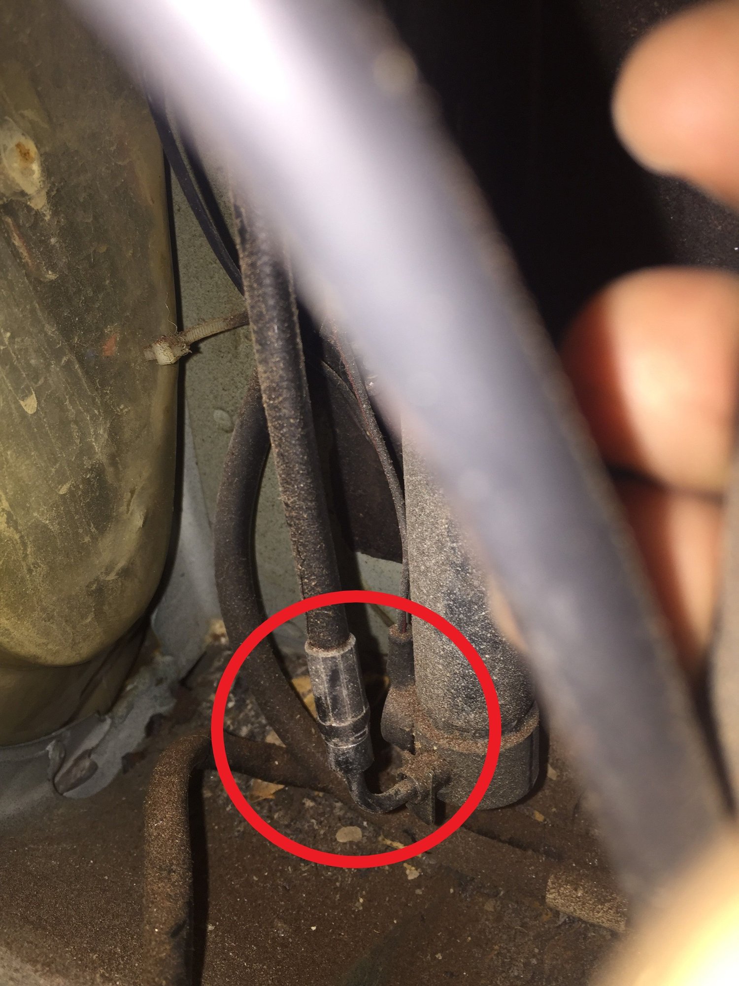

I would first try this. There's microswitches on the right hand cylinder ram that tell the car where the position of the cylinder rams are. Only when the top is closed do the rear quarter windows close.
Connector at bottom right cylinder ram.
Try to short the connectors (which I'm presuming you left in the car when you took the rams out) and then push the open/close top button by the J Gate module. Obviously you'll need to re- connect the battery.
Alternatively you can try "jumping" (a la putting 12 V directly on) the window regulator connection pins, for which access will be your major issue. Not too bad but definitely easier with the top open.
