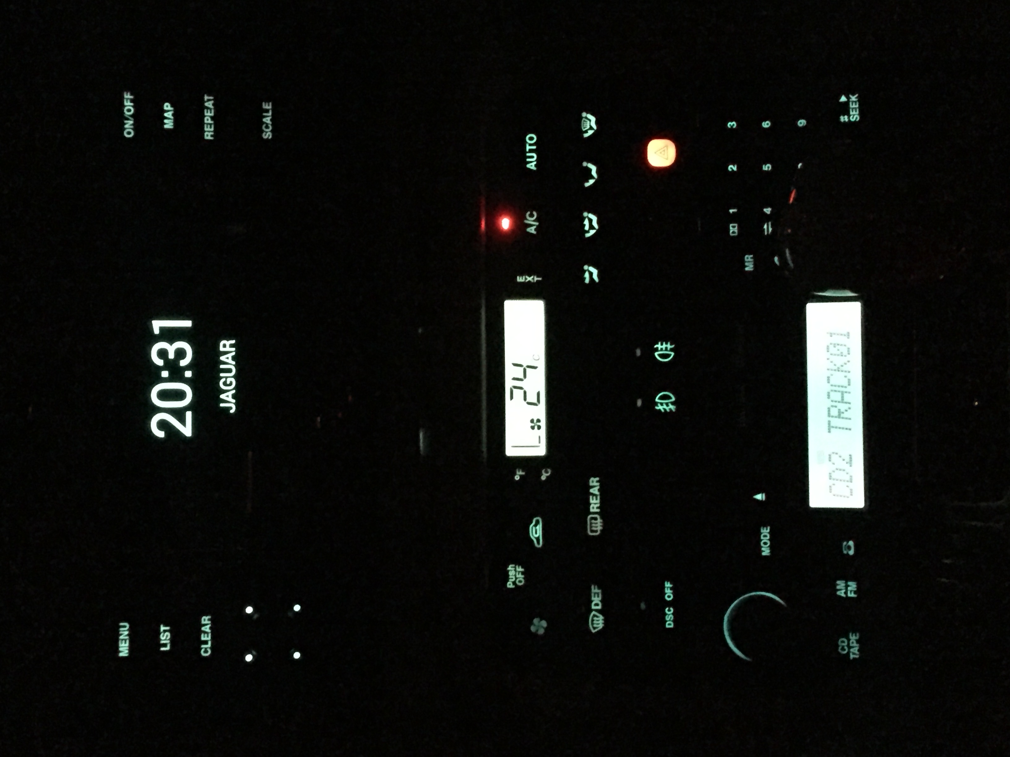

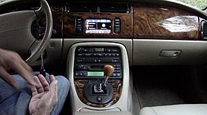

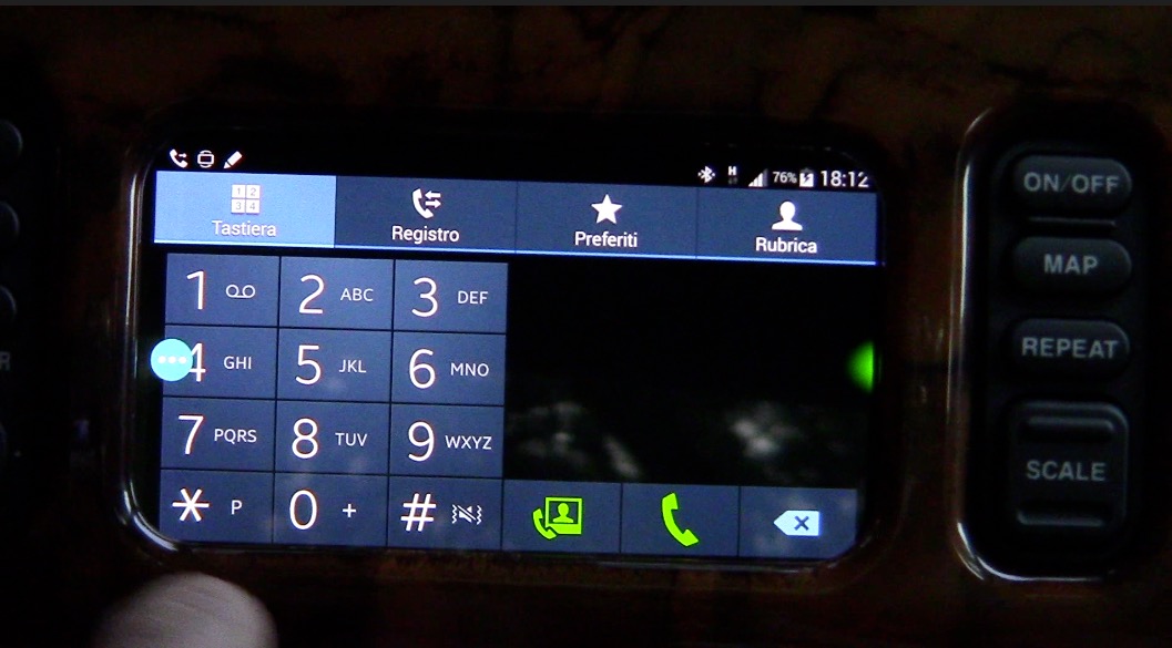

The standard and obsolete navigation system has been replaced with a modern multimedia touch screen player without altering the aesthetic appearance of the dashboard. The system also includes the perfectly working phone in hands-free mode.
Integrated apps like google map, internet, you tube, video movie player, whatsapp, facebook, notes, calculator .... etc etc.
the native stereo system with tape radio and standard cd works in conjunction with the multimedia system mounted.
All perfect.
Hello to all

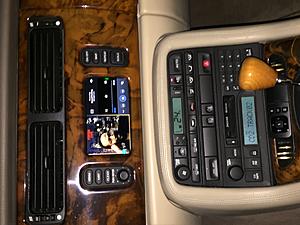

I disassembled and extracted native Navigator panel, opened it and extracted the only display by leaving the Connector Connected to have Night Illumination. in the empty compartment I have inserted with precision a simple samsung galaxy note 3 which is the ideal size and capacity. I then plugged in a power cord to load it with the ignition key in position 1.
closed the package and mounted the panel.
for the simultaneous use of the standard cd player and note 3 I have mounted the following accessory: JAG-CDR Auxiliary Jack, Changer Retention Kit for Select Jaguar XJ and XK: JAG-CDR Auxiliary Jack, Changer retention Kit for Select Jaguar XJ and XK :: iPod Adapters & Interfaces .html.
this is all, best regards to all.
