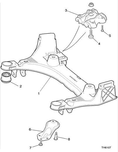

The front crossmember has four mountings:
Presumably it's item 2 (the round rubber bushes) at the front and not item 3 you're concerned about? Whilst there ought to be some slight flex, it should still be attached to the car! Check the rear ones (item 3) as these can leak.

I am not replacing the cross member mounts, however I think I have worked out the movement issue, its only a couple of mm and the cause is simple now I have a clearer mind.
I have the car on stands below the cross member, the movement seems to be the flex in the rubbers due to the cars weight shifting slightly as I manipulate the fulcrum bolt.
