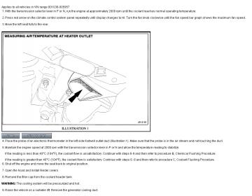

It sounds like a clogged drain line and you will need to get it cleaned. On my 93 xj-s all I needed to do is use an air hose from the outside. A few short spurts and it was clear. If it were coolant you would smell it. Jag has a TSB 303-11 on the low heat and says to do a performance test, chemical flushing and refilling cooling system. I will attach both for you to print you may not be able to read the popup.
If you bring up the thumbnail and print it, it should print to normal size. If that does not work let me know and I will send it to your e-mail that you provide me in a PM. I think we need to talk to management about the size of the view.
PS; blowing out the line is from underneath the car where drain exits.
