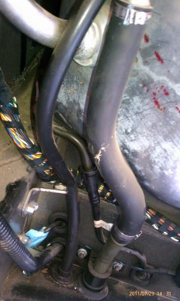

Good news for me, I took another look at my hoses and finally found the issue. It was the little tube in the trunk that goes from somewhere behind the tank to the inlet to the first canister. It was disconnected and hard to tell.
Look at the picture, it is the small hose. To see it you have to take the gas tank cover off.
