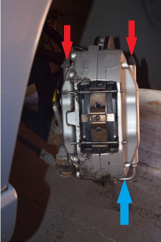

Brembo front brake - aluminium with fixed caliper. two bleed screws (arrowed in red) and a balance pipe (arrowed in blue):
Where Brembo's are fitted, they usually have ventilated brake discs but I've seen examples with plain discs.
