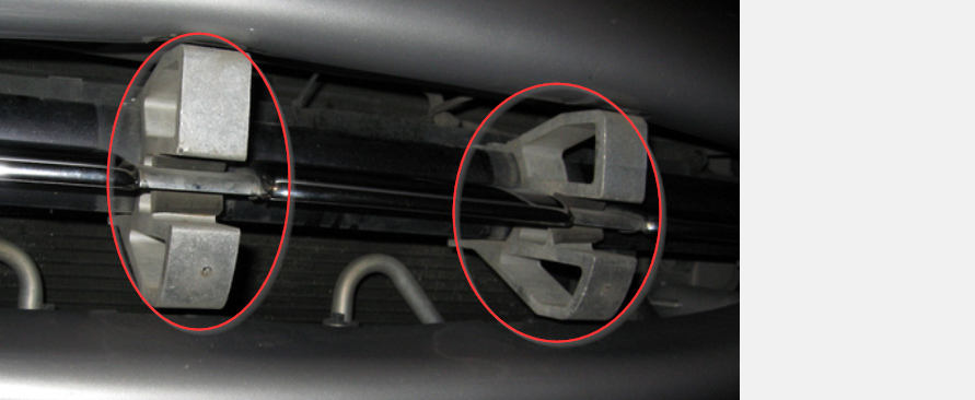

Hi all,
so I am curious; can anyone tell me the function of the metal bumper overriders on the xkr? i.e. these bits (this photo is from an xk8, but you know what I mean.
The reason I ask is I am installing a single piece mesh grille (the obligatory Mina gallery piece) and its goes over the top of these overriders out front of the bumper cover; I am sorely tempted to go off-piste and mount it behindthe bumper cover instead so it looks more recessed, i.e. like the OEM 3-piece XKR grille, but without the overriders. The metal overriders appear to be riveted in, so removal will involve some drilling, grinding and swearing and ill probably have to dremel out a little clearance from the bumper cover, but it all looks doable even if the rivets at the top cant be accessed with a drill without a LOT more dissassembly, so would probably have to grind those off sideways. I could also take a grinding disk to the overriders themselves and cut them off which would be easier, but I always try to do everything reversibly - i.e so if I wanted to I could rivnut, rivet or tap/bolt them back on and restore the original 3 piece grille look.
So before I go hacking away at my obstensibly very clean 34k miles car I thought I should check... what are these metal overriders for? Are they designed to be crushable/deformable structures in a collision? I.e. are they a significant safety piece? I like modifying cars but I do have a personal principle of never doing anything that subtracts safety.

Bumper regulations have changed over the years and vary from country to country. All designs must take minimum 2.5mph impact and I believe the USA is 5mph (which is 4 times more energy). Many regional X100’s also have the impact absorption features on the bumper beam mounts at the outer over-riders (which are hidden behind the bumper skin and each side of the ‘mouth’.
These combined features are designed for deceleration and damage limitation. If you remove some, then low speed impact damage will be transferred to more bodywork and the cooling module - much greater cost...

I installed the Mina Grill as well and just drilled out the rivets holding those supports in... I think they are more of a 5-mph protection for the bumper but other than that no real help in a collision. Make sure to spray the inside area black so it all blends in through the grill.

^^^^^^^ this is exactly what I did. Anything over 5 mph and those metal supports are no help.
Furthermore, unless you are hitting a flat wall, or another XK8 / R head on, those overriders won’t help at any speed over or under 5 mph.
I don’t know about the vehicles in other locales, but around my area of the country 99.9% of all vehicles are way higher than our XK’s. The entire front end of the Jaguar XK’s will slide under the other vehicle and their bumper will magle our “bonnet”, etc. So those metal overriders are serving no practical purpose.
Off they go.
Besides, the Mina Gallery grill looks stupid unless it’s recessed. Just take off the XK’s “nose cone” and attach the grill the much better way..

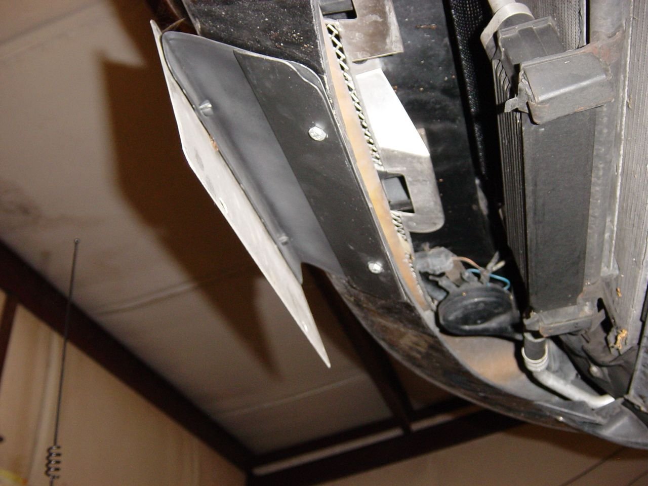

I did not have holes drilled on either of my XKRs but Texas requires a front tag so I used an old tag and some sheet steel for reinforcement and mounting.
Two holes near the bottom edge of the front bumper cover where it rolls under.
Bent an old TAG and used some sheet metal screws to put the legal front one in place.
One pic is my Black conv. and the other is my Platinum conv.
