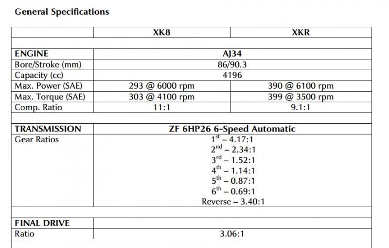

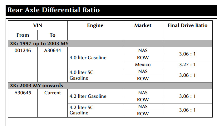

So I see the XKR from a search has the 2 piece drive shaft as my Lincoln does. While I did find some threads on the gears, I didn't see what the XKR came with stock...
Old Jul 18, 2012 | 11:22 AM
Stumpy's Avatar
Joined: Nov 2011
Posts: 578
Likes: 207
From: Devon, UK
Here are some transmission specs for the 4.2 version and rear axle for 4.0 and 4.2
Edit: add 4.0 Mercedes 5G Tronic spec. I believe the W5A580 version is fitted to the XKR.
Attached Thumbnails XKR Motor Swap-4_2_spec.jpg   XKR Motor Swap-axle.jpg   XKR Motor Swap-5g-tronic.jpg
Stumpy,
The first picture in your post shows the engine as a aj34, My LS has an AJ-V8 I am not sure of whether or not is an AJ-XX or what though, do you know what the difference in the numbering is
