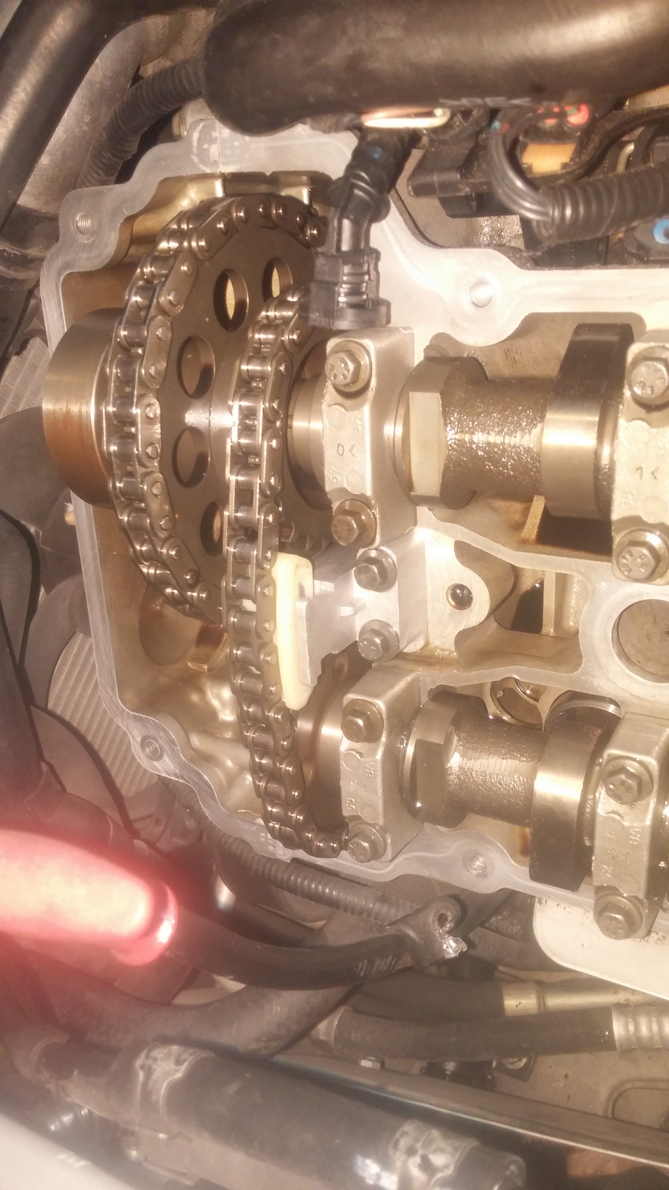

New tensioners installed a few weeks ago. I used Lincoln LS tensioner with cut down bolts. About two days before tensioners arrived (just over 75,000 miles, left hand drive) the bottom shoe of the passenger side tensioner came off and followed the chain around the exhaust cam gear. This caused it to jump a tooth. Luckily it was just one tooth. I think if it had jumped two teeth then valve/piston damage would have occured.
Symptoms were check engine light with a loping idle (like a slow gallop) and low idle speed. Otherwise drove fine. At first I thought mis-fire, coil, fuel injector etc.. Drove home (10miles) pulled the codes. Several codes all from the same bank. Lightbulb moment! Pulled valve cover for verification.
Replaced tensioners and moved chain one tooth back. All the timing flats on cams from both sides now line up parallel to head. Leak down check and compression checks all uniform. Finally a camera inspection within the cylinders confirmed all valves/pistons were untouched. I got very lucky! Runs like a champ. I'll post a seperate page to this experience with photos later.
