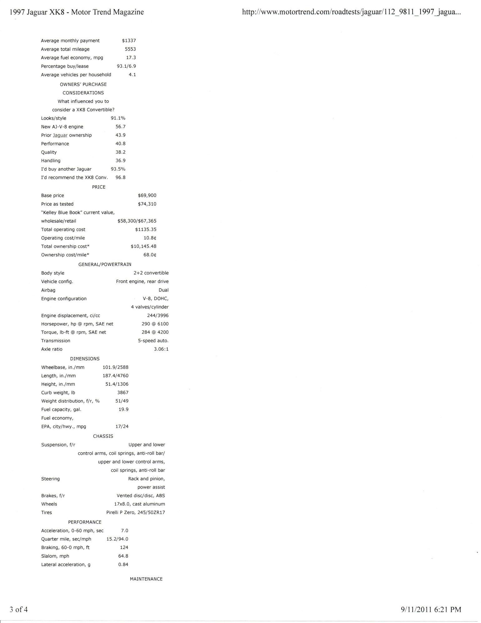

The numbers on the sticker are not the front/rear weight distribution, they are the gross axle weight ratings (GAWR). That is the maximum weight on each axle when fully loaded with four passengers,fully fueled and maximum weight of cargo in the trunk. If you add those numbers together you should get around 4600lbs which is the gross vehicle weight rating.
The curb weight is about 3800 lbs for a convertible and about 3600 lbs for a coupe. Fully fueled with no passengers or cargo F/R weight distribution is about 51/49 for a convertible and 52/48 for a coupe.

Specs from Motor Trend road test 97 convert

those numbers are from an early year car (1999 I think), and it comes from one of the shop manuals, but I don't think it will vary much by year. I think you will be within 100lbs of those numbers regardless of year.
I don't know of anyone that publishes dry weight, the numbers I used above are curb weight, which includes all fluids but no passengers. To get dry weight I would take the curb weight for your car and and subtract the weight of fluids:
-119lbs for fuel
-24lbs for antifreeze (assuming xk8)
-17lbs for transmission fluid
-12lbs for motor oil
-7lbs for window washer fluid
-4lbs for the electrolyte in the car battery
-2lbs for power steering fluid
I would ignore the weight of the brake fluid
That should give you an estimate of dry weight.
