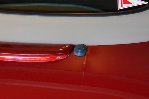

Here's how I did it: It's mounted on the dash with Velcro, allowing me instant removal and storage in the trunk when parked with the top down. Ran the antenna wire under carpet and rear seat and out to trunk lip where it's held by the magnetic head. Power to a multi-socket on the floor behind the driver's seat -- only visible to the rear-seat passengers ;>) All wires tucked in wherever available. Sound output through the cassette head.
Admittedly not the most aesthetically-pleasing installation but it has worked perfectly for ten years and gets the job done. Any old port in the storm when you gotta have music.
