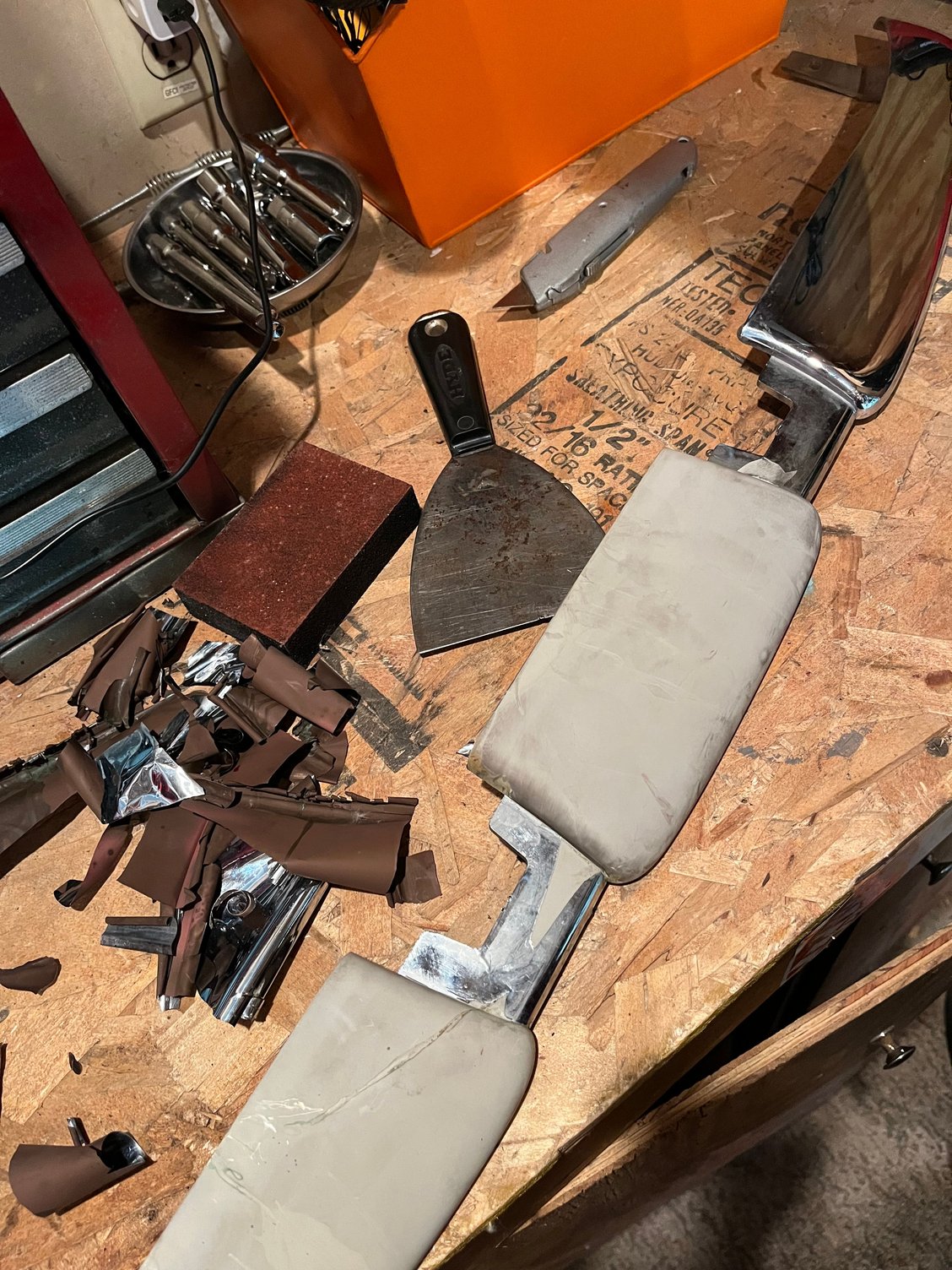

I can’t recall the name of the piece, but it’s thin decorative chrome in the nose.
Anyway, mine had begun to peel, and it’s been on my list to replace or repaint. I decided to take it apart and see how bad it was.
I expected a paper thin film which I could scrape and sand, then prime and paint. Instead, I found a thick metal covering which peeled off in sections. It was like the thickest aluminum foil you can picture, and I used a metal scraper to get it loose without damaging the plastic beneath.
I then lightly sanded it, and primed with flat black. I used three coats of Dupli-Color Perfect Match Chrome, 20 min between coats. Let it dry a full day.

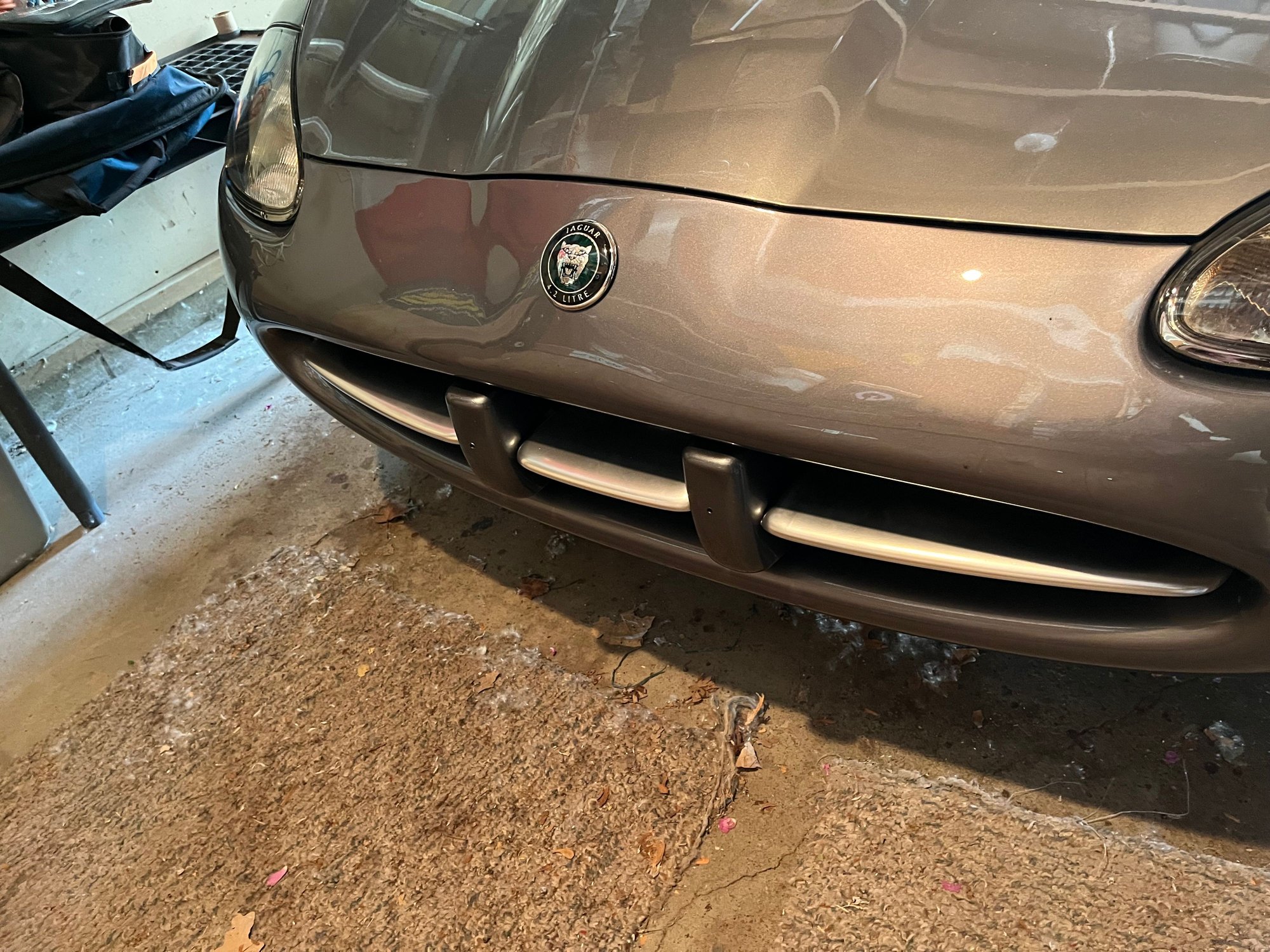

Attached are the pics. While this is not a mirror finish, I’m very happy with the results. The final product matches my silvery rims perfectly.

Scraper tool worked best
Final result
Final result
