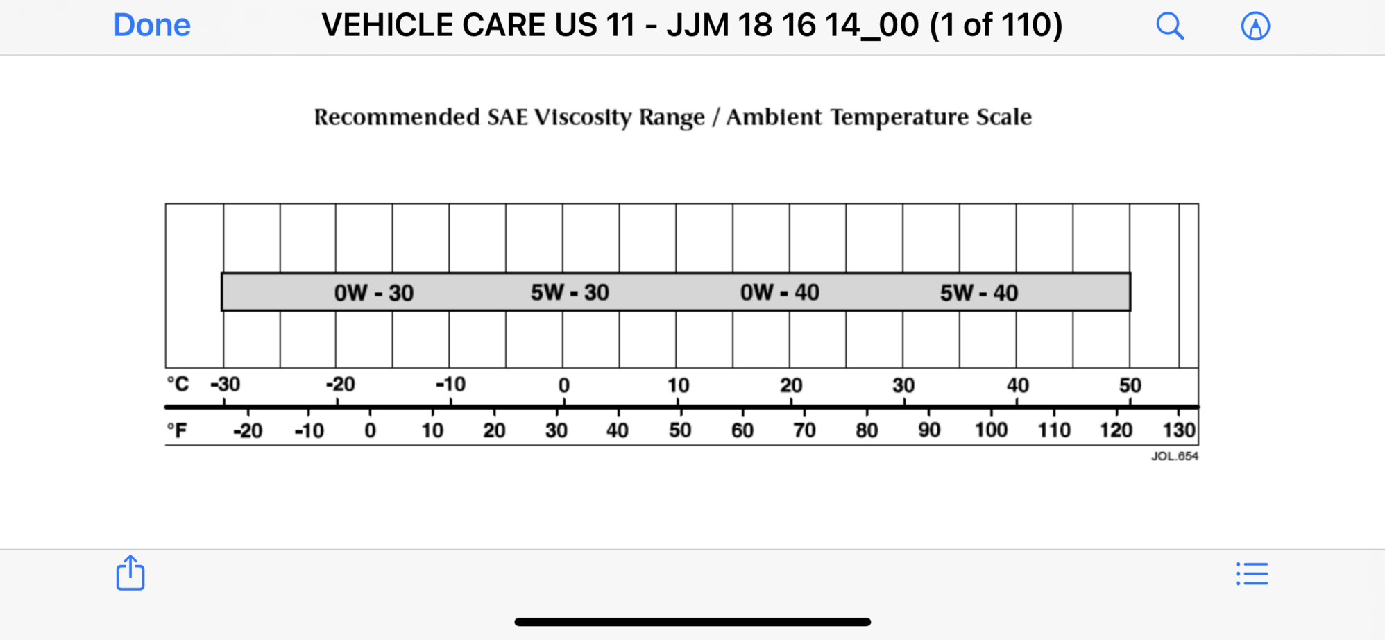

my owners manual specifies several different viscosities of oil that are appropriate, each depending on the general ambient air temperature.
for my climate the 0w-40 is listed as correct (see attached photo).
Z
