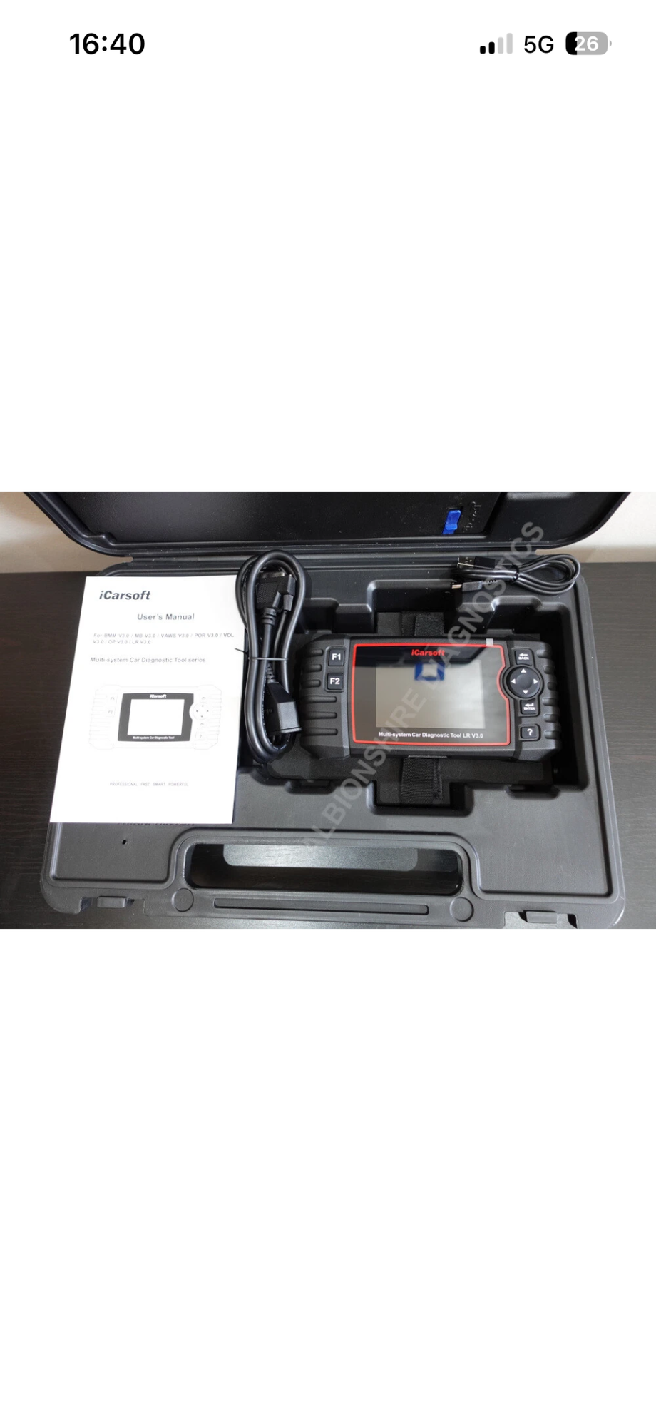

Default Check the cooling fan
I had an overheating issue on my 5.0 litre XKR. I changed the water pump stat and new housing to no avail. It was fine on the run, it only occurred during traffic or standing still. Now I’m in the UK so we don’t see high temps like you do in the USA, I ended up changing my electric fan housing and motor. With the OBD reader I have you can speed up or slow down the electric fan to see if the fan responds. With my old fan it wouldn’t blow out a candle even giving it 100% speed reference, once the fan was changed at 100% you can physically hear the fan. So if your car is overheating and you cannot hear the fan going flat out to compensate at stationary or low speeds, I would check this. After I changed the fan I had no more overheating problems.

What software do you use to control the fan speed?

Default OBD Reader
My OBD reader is by iCarsoft with version 3 software with the JLR option loaded. I found this on eBay. It’s not the cheapest but it’s a great tool for self diagnosing. I had 2 independents look at my fault, but it ended up me who tested and made the decision to change the motor.
