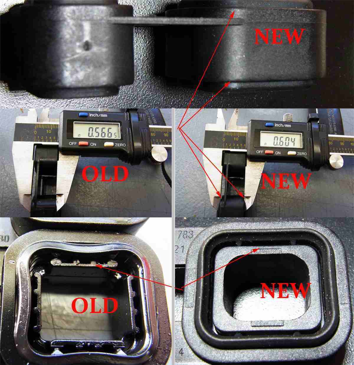

Yesterday I removed the car cover and pulled the valve body out, inspected the connection sleeve (which was not leaking externally, had @ 3.5mm gap from the housing) and the connection piece collar. Nothing stood out as problematic; the rectangular connection piece wasn’t cracked or cut etc. The only thing I did notice is that the hard portion of its body is slightly taller than the original one and the inner cavity walls are of a different configuration. Could this cause my problem?
The part came in a Bapmic kit #BACB12-846003
Although listed primarily as a bmw zf6hp26 part it also is cross referenced everywhere I have seen as a proper kit for the x100 zf6hp26 transmission.

I was getting ready to install the seals once more and saw that the seal had a hp19/21 part number on it.
Further research shows that most aftermarket companies include this 'incorrect' seal in their hp26 kits.
Where can I purchase an oem seal online? Any help would be appreciated. (a url would be awesome)

my leak was caused by a worn front shaft seal...rebuilt transmission is my cure as I fubarred the original by trying to add a seal 'sweller'. The sweller worked exactly as people warned me...it did swell the seals but it also softened them so much that they turned to jelly after several weeks and one morning all of my transmission fluid was saturating my garage floor.
