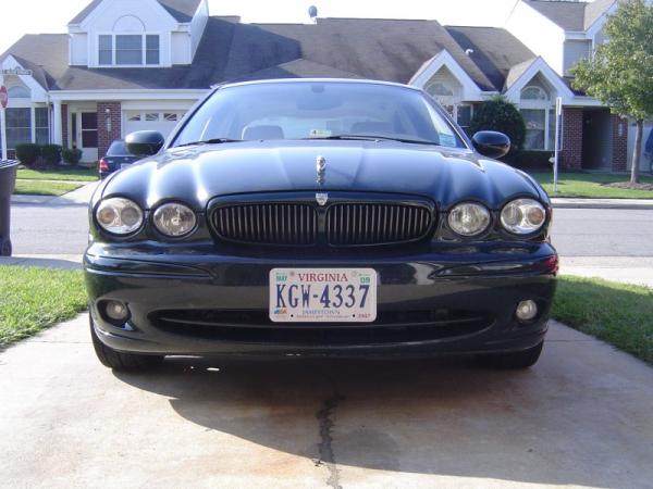

innzane, I have done a few, but nothing to really make the car stand out. More something to make people realize I did something different, but not be able to put their fingers on what I have done.
I painted the chrome bumper corners to match the body. I did the same treatment to the piece above the license plate, but left the word "Jaguar" in chrome. Then I removed all the badging on the back of the car. I also color matched the trim piece at the bottom of the bumper where the backup sensors sit. Like I said, nothing spectacular, but it gets peoples attention.
This is what I did to the front. Here I color matched the grille surround, the chrome bumper corner pieces, and the splitter in the lower radiator intake.
If you can do your own painting, you can do all of this for around $50.
Beyond that, keep looking. There are a few things that others have done. I am also in the process of doing a complete LED transformation and I am doing it the "hard way" by using 10MM LEDs and wiring them up, not using the store bought pieces. I get better lighting and the cost is much less. But, you have to know how to wire in LEDs and the like.
How exactly did you paint the chrome trim

Vunnal, I removed the trim from the car first off. Can you paint it on the car. Sure. But, I have found that most likely you will end up leaving a little bit of chrome somewhere. So, removing the pieces is the better way to go. Besides, once you factor in the time spent masking off stuff, it is about the same time it would have taken to remove the pieces.
Once you get the pieces off, you will want to use some 400 grit sand paper to scuff up the chrome surface to give the paint something to bite into. At that point, get yourself some etching prime (this is not a normal primer) and paint the pieces. The etching primer will bite into the chrome to allow the paint to stick once you apply color. Once you have the etching primer on, paint the pieces like you would any other item.
Please note, the lip on the trunk lid still has the word "JAGUAR" in chrome. This is my twist on things. If you decide to do this, sand the piece like mentioned above, but don't sand down into the letters. Then fill the letters (keeping the piece pointing straight up) with Elmer's white glue. Let the glue dry. Use a toothpick to push the glue to fill the letters completely and keep adding glue till it is bubbled up about as far as it will go before spilling. This needs to be done to give you something to grab on to later when you remove the glue. After the glue is dried, paint the piece, but remove the glue before you put the final layer of clear on the piece.
Kinda like the Jaguar emblem on the grille simply comes off by removing the fasteners on the back side. I then reinstalled it once the piece was painted. This left just enough chrome to stand out.
If you need more help, let me know. Removing the bumpers may sound like a big job, but after doing it once, you will figure out that it is pretty easy to do.

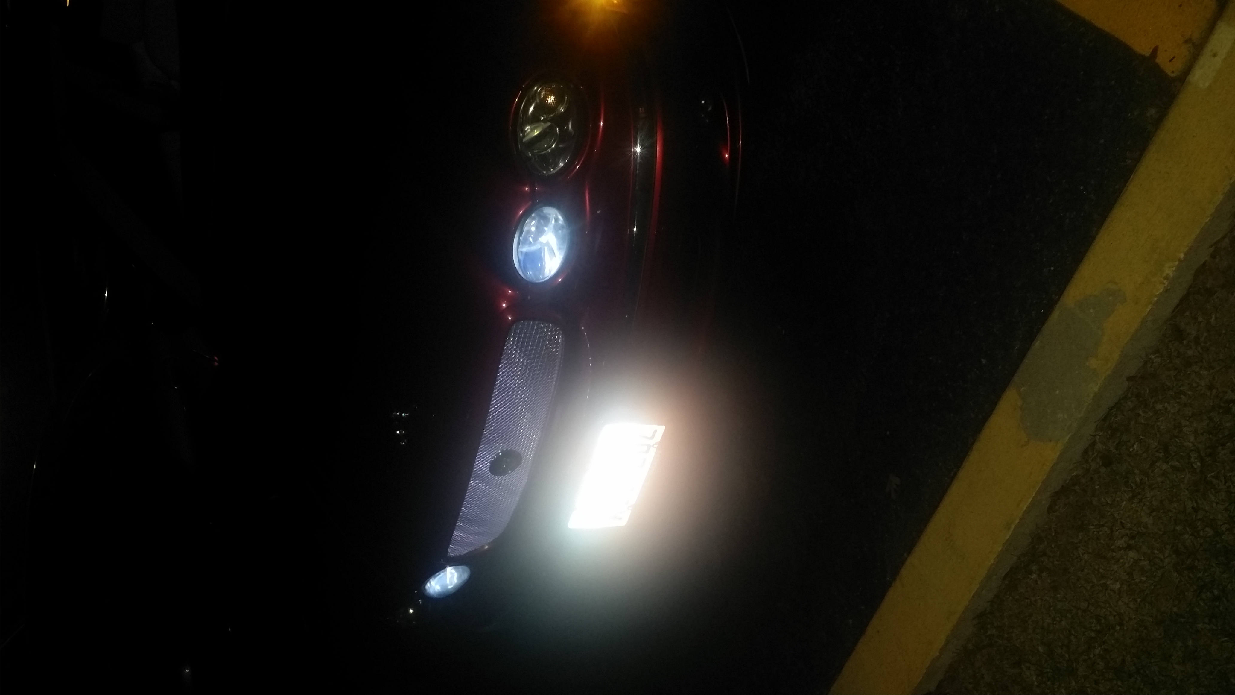

LED light strip in hood lighting up the chrome mesh grill. Flash sorta mucked the pic with reflective glare, but you get the idea, looks nice.
