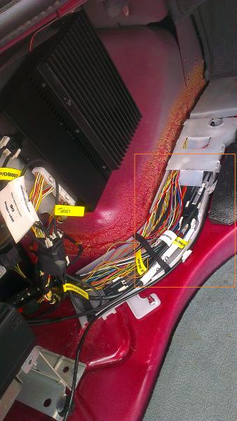

I had the same problem, the sound was going on/off from time to time with the CD changer button not doing anything.
I opened the trunk lining and checked the connections. From what I can see there is a small design flaw in the connection wiring (optical) of the cd-changer, for one the cable is a little short and forces the plug and second the mother plug is fixed on the plastic protection board and keeps an angle upwards so the plug clip can easily unclip. Also the hole assembly is curved and that puts another force on the plug.
I found the plug uncliped very hard to spot, the plug is still sending data but throwing errors from time to time.
I put a piece of paper under the fathers plug to lift it a bit and hopefully it will stay clipped.
Attached Thumbnails 04 XJ8 - Alpine Premium Stereo works but NO SOUND??-imag1930.jpg   04 XJ8 - Alpine Premium Stereo works but NO SOUND??-imag1929.jpg
