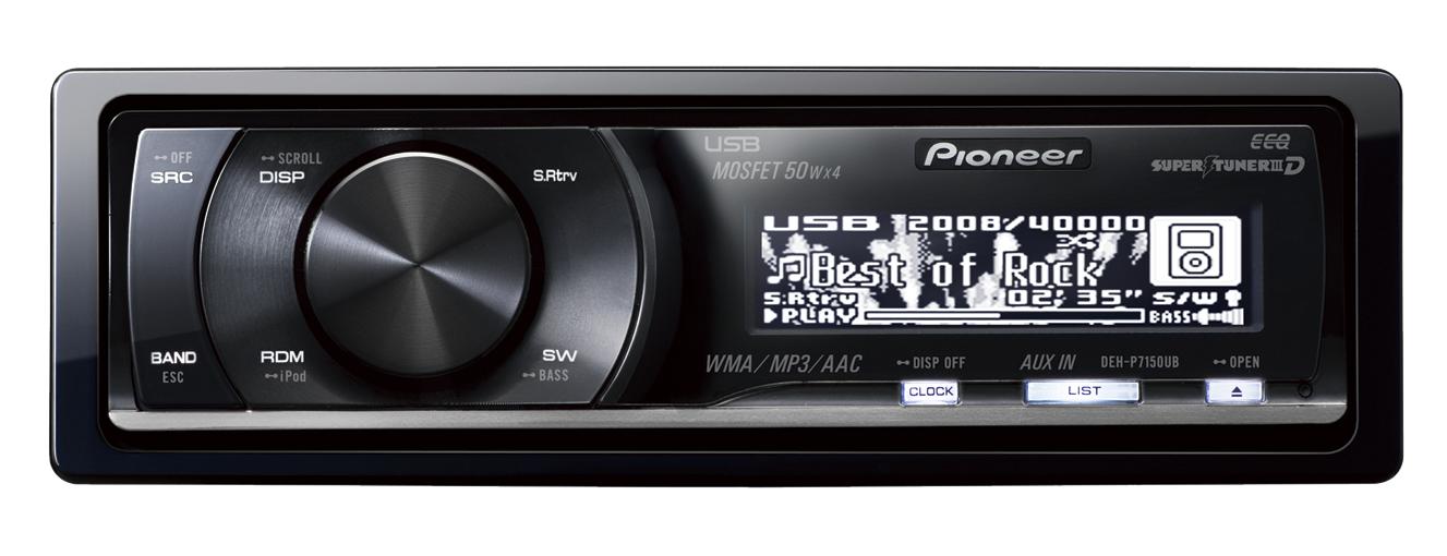

Now that I've had this unit for a month or so, I thought I should write a little review. I guess here is as good a place as any.
Pioneer DEH-P7150UB

Appearance:
The DEH-P7150UB sports the same finish as all Pioneer’s recent consumer grade home AV equipment; fingerprint-magnet gloss-black (I believe they like to call it "Piano Black"). I would have rather was finished in matte to match the Jaguar modules positioned above it, but beggars can’t be choosers - it was hard enough just to find a unit that didn’t appear to be modeled after Optimus Prime. Here, Pioneer have at least attempted a little understated elegance.

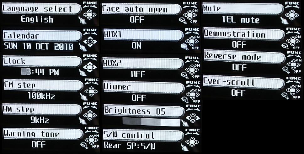

Upon installation, it is advised to press the tiny reset button in the lower right corner of the bezel, then run the Initial Settings Menu by pressing and holding the volume knob in while the unit is off.
Initial settings menu screenshots
This will give you the usual ‘first run’ configuration options (such as language date and time), as well as a few interesting ones. Some worth noting are:

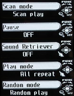

The submenus are Function (playback options), Audio and ‘Entertainment’.
The settings in ‘Function’ are self explanatory save ‘Sound Retriever’. Sound Retriever, Crystallizer, glorified Loudness – call it what you will. The aim of the setting is to increase dynamic range in the playback of lossy audio files (ie.MP3):
Function menu screenshots

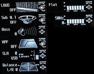

‘Audio’ harbors a bunch of settings such as Loudness, Balance/Fader and Equalizer. Being of the audiophile mindset, I'd usually have all 'enhancements' such as Loudness and Sound Retriever disabled, and the Equalizer flat. ‘SLA’ is an intuitive feature that allows you to adjust the gain for individual sources, thus preventing large variations in volume as you switch between them:
Audio menu screenshots
